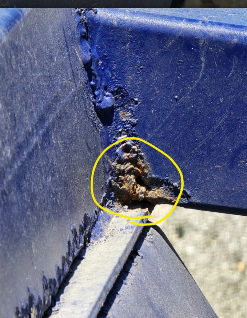

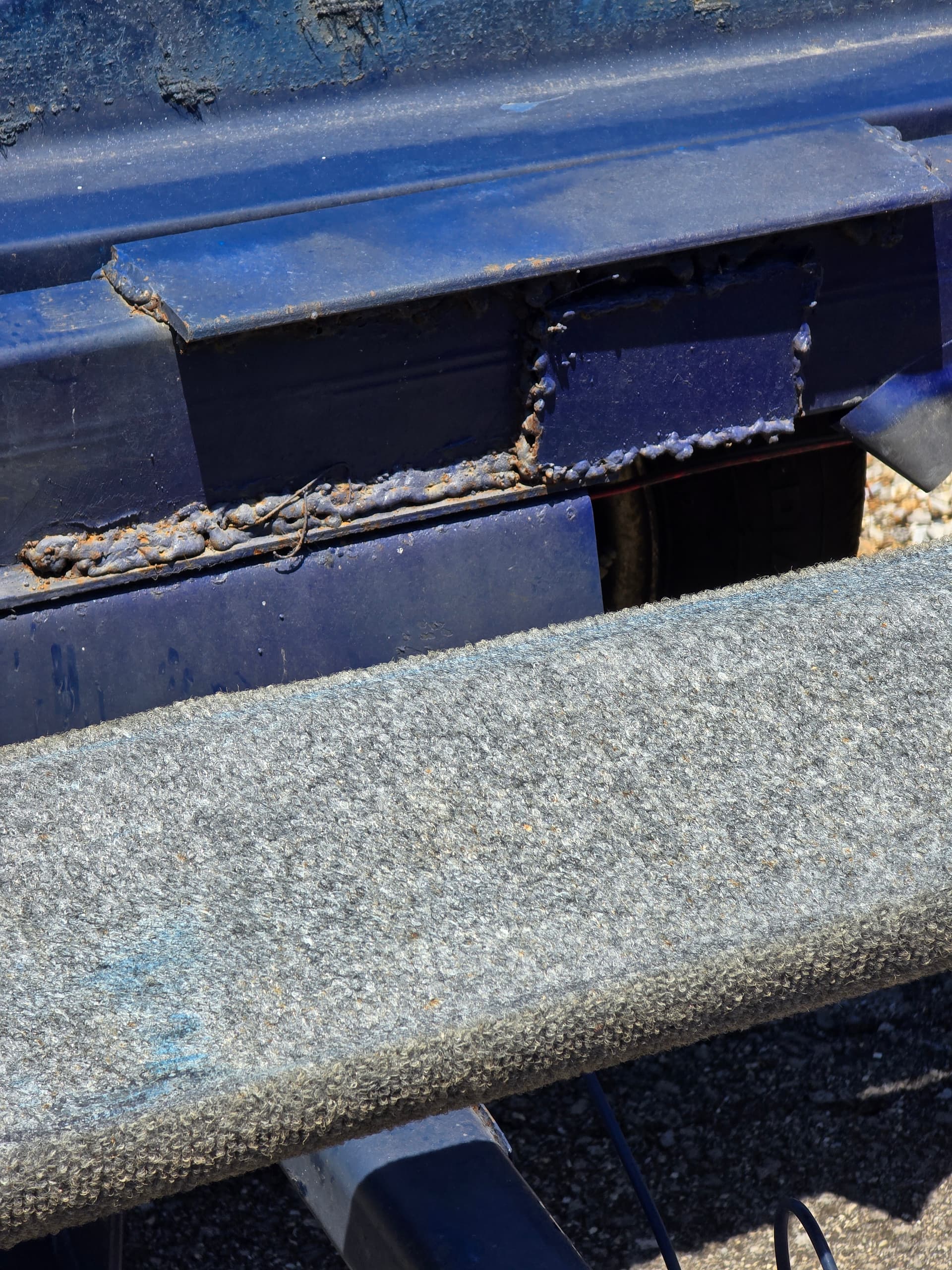

A man came to the Marina today to get an axle spindle fixed. I took one look at this repair job and told him my insurance would not cover me.
I believe that our own @ChelanJim has gone in the welding business.
The trailer is so rusted out that you can literally poke your finger through the main beams.

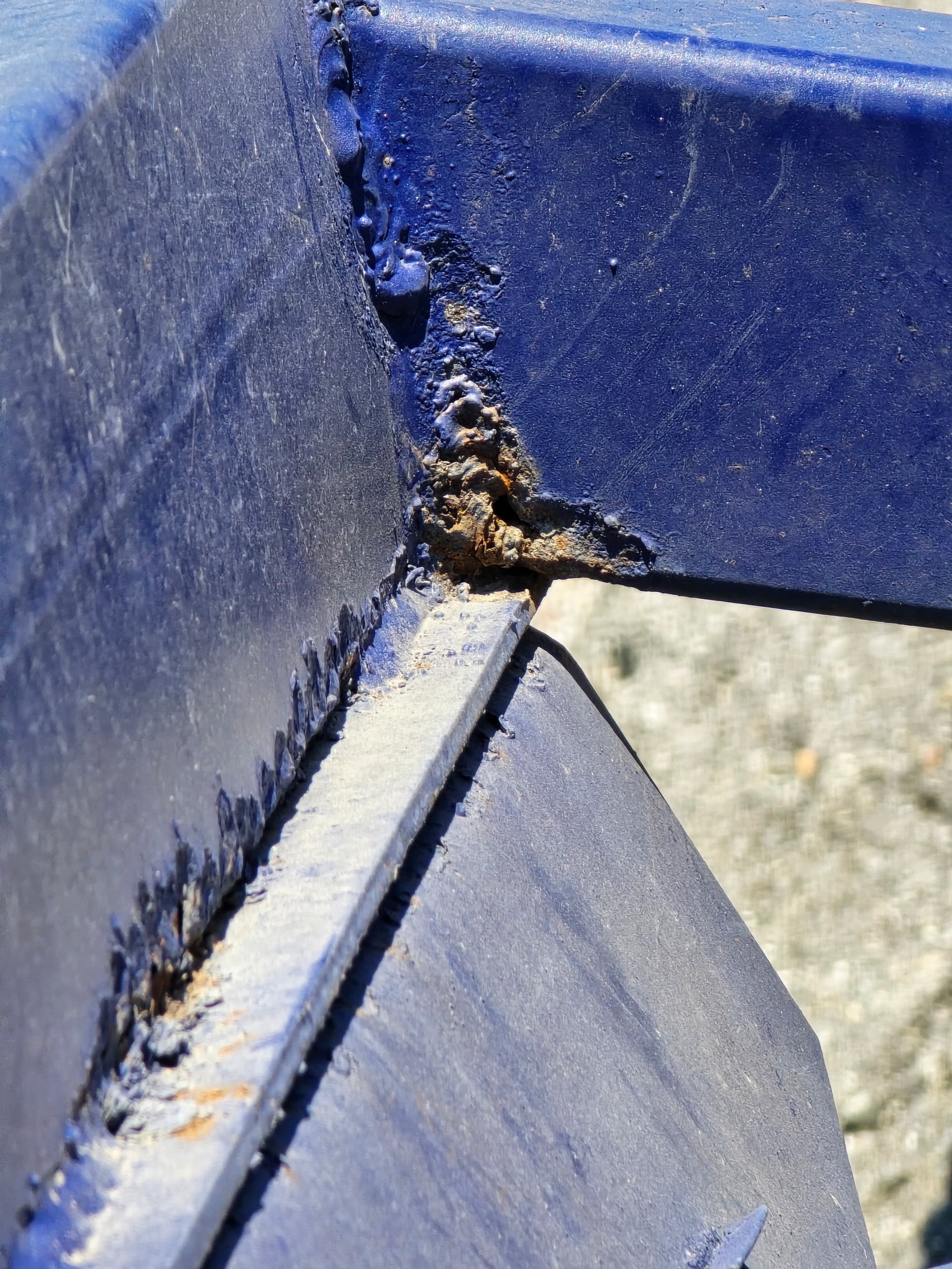

Mabe I am the only one… BUT… what’s wrong here? :stuck_out_tongue_winking_eye: :rofl:
I am certainly not the best welder in the world, and I know that everyone has to start somewhere but…come’on man.
It’s kind of scary that things like that are out on the road.

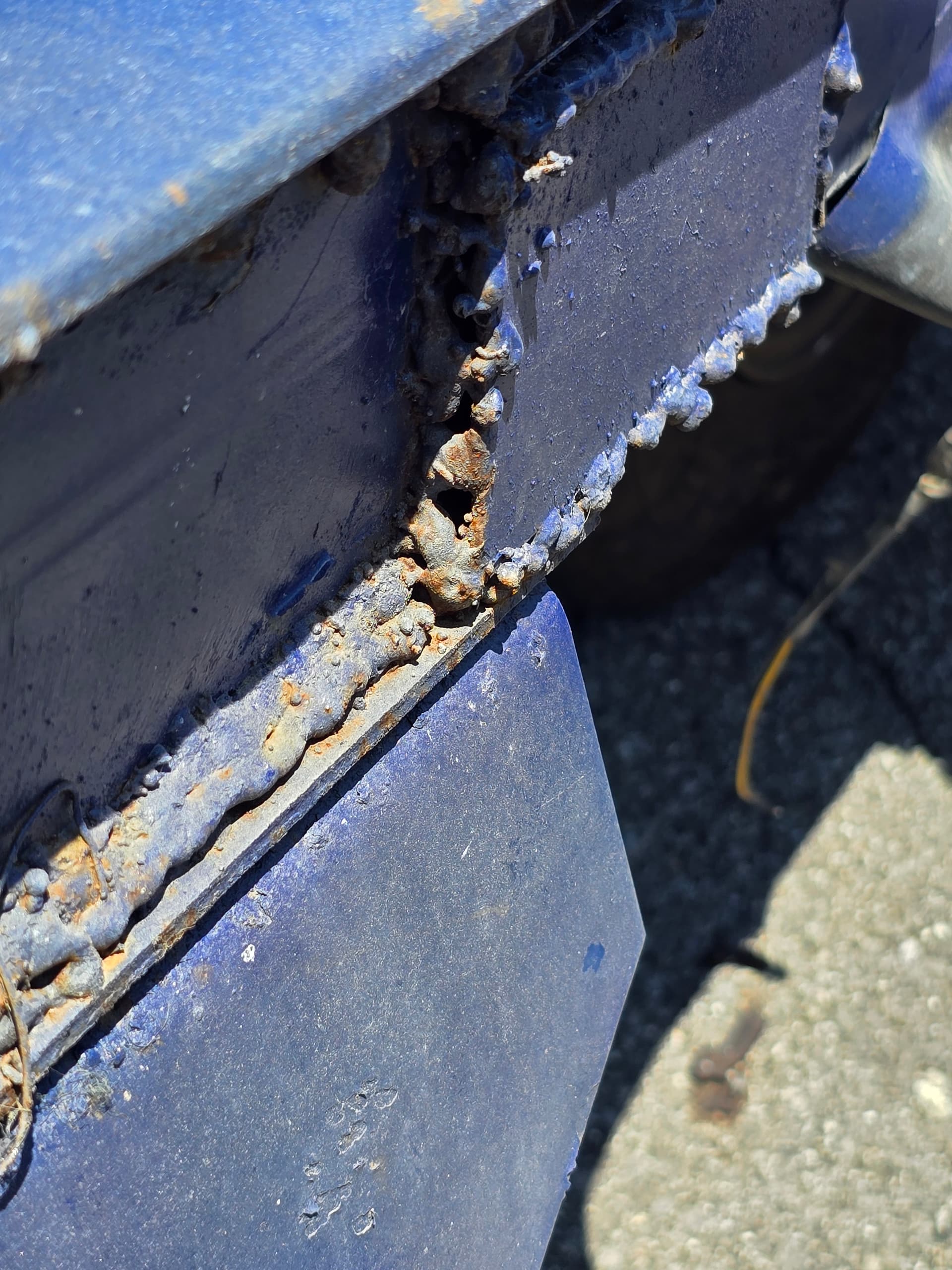

My 10 year old can run a better bead! I’m not a welder but my turd strings look better than that and still get grinded because I’m embarrassed :joy:
Unless you’re being sarcastic (never can tell), the first thing that jumps out at me is the lack of a ā€œwetā€ edge on all those (ahem) ā€œbeadsā€. Additionally, there appears to be little (if any) fusion between the beads that are stacked.
In my humble opinion, would not pass the hammer test.
I was joking :stuck_out_tongue_winking_eye: :rofl: My welds are not great… not sure those could even be considered as welds. :man_shrugging:
Everybody has to start somewhere… preferably not on something being towed down the road.

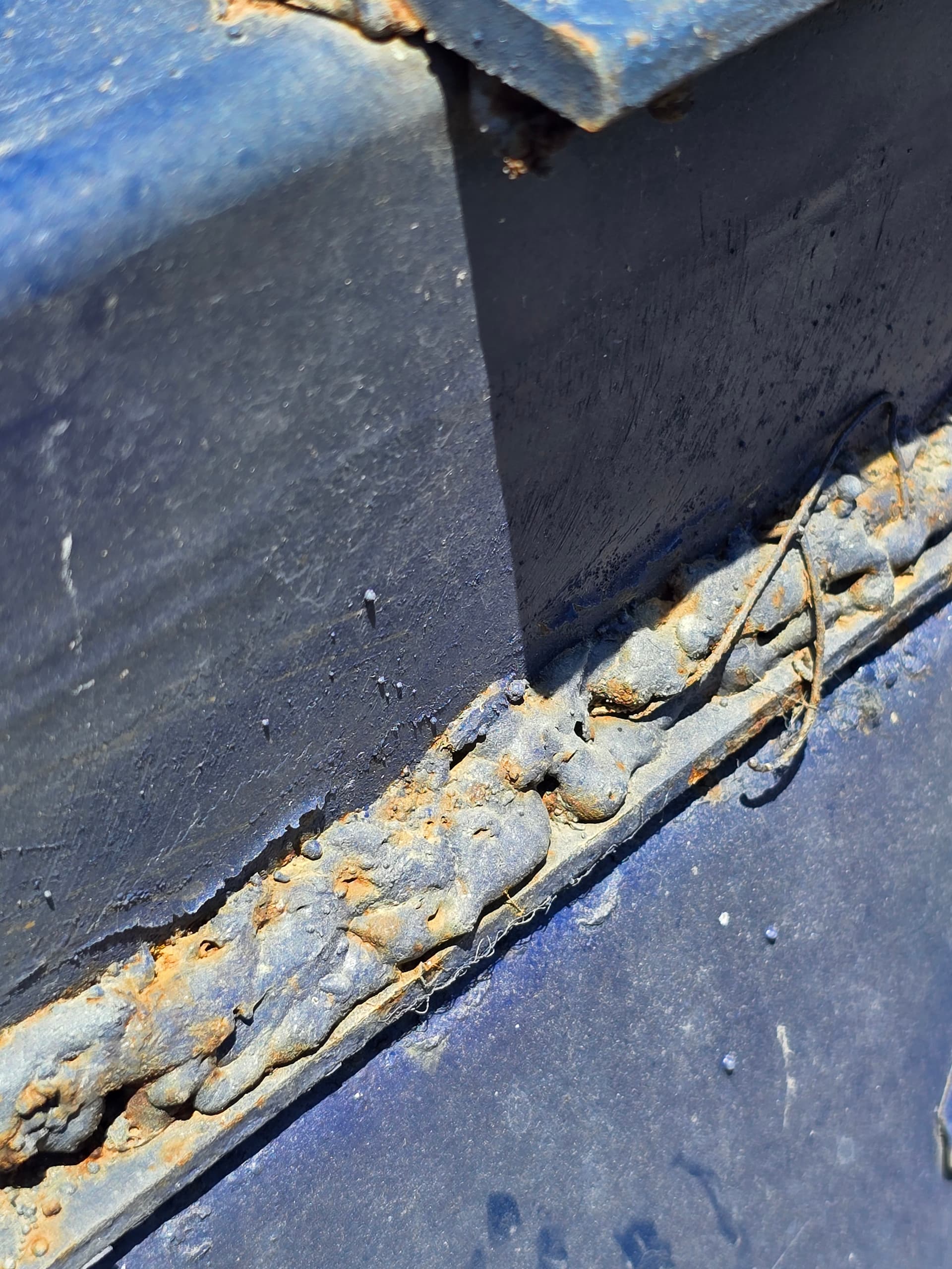

You can’t blame him here… Hard to grind in those close corners:
Hmm… Die grinder!
I use a Dremel in such spots. :stuck_out_tongue_winking_eye: :rofl:

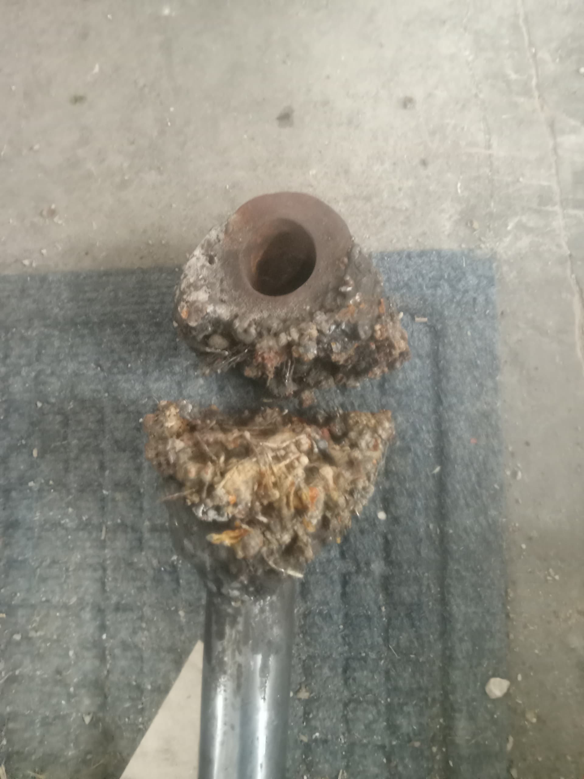

We had someone bring this hydraulic cylinder into the shop that they had ā€œfixedā€ once already.
Words can’t describe that one…
That weld failed? That is interesting. :thinking: :stuck_out_tongue_winking_eye: :rofl:
Obviously, the gold standard with welding is ā€œstacking dimes.ā€ That photo shows the opposite called ā€œbird nesting.ā€ That is not even worthy of acceptance into the ā€œGrinder Club.ā€ Grinding won’t disguise that one.
Another ā€œGrindersā€ motto: ā€œOur standards may be low but they are not that low: part has to break in another spot.ā€
I have heard it said if you’re weld isn’t great put extra. I don’t believe that line. This person is a overachiever for sure.
I believe that may best be described as a metallurgic venereal disease.
:thinking: I’m thinking there has to be a better description than that! I stopped trying to fathom what THAT disease might entail…
