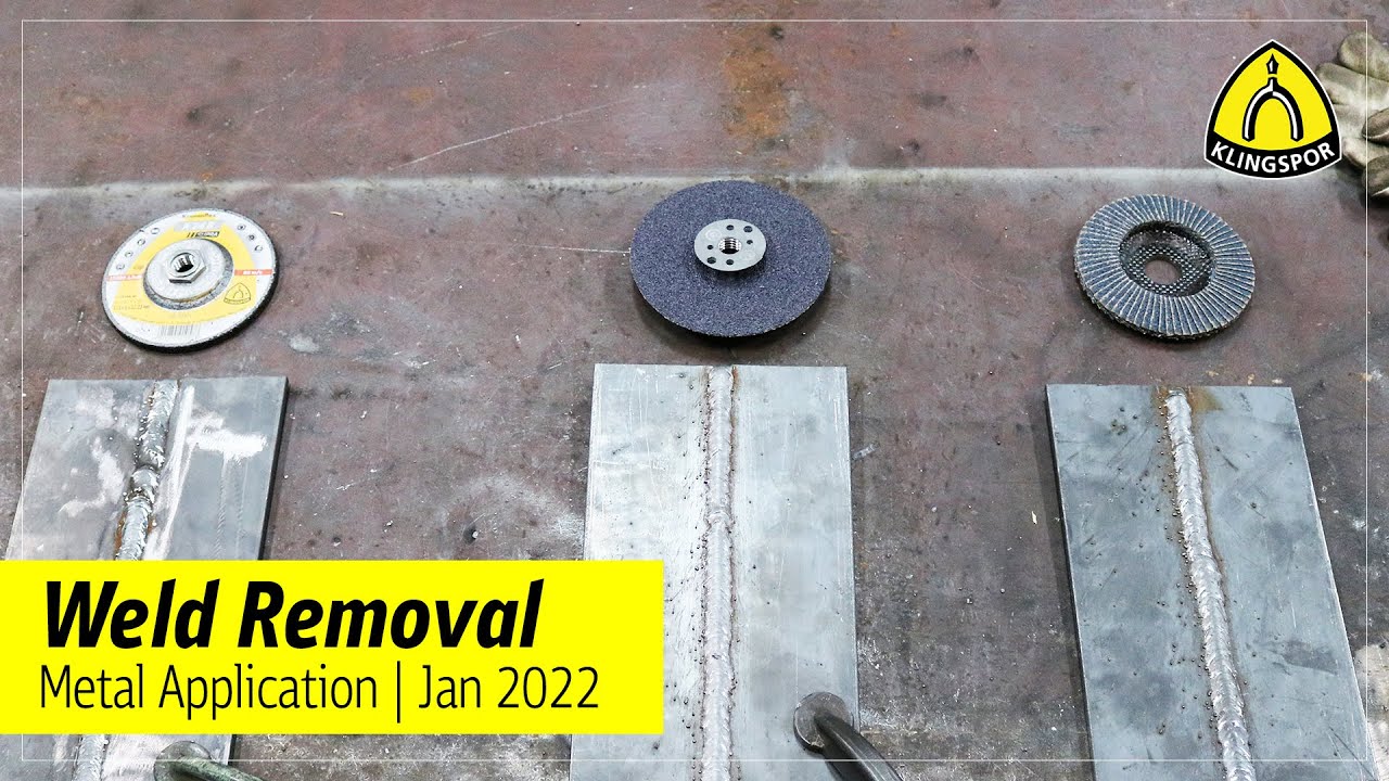

here is a couple of video’s of different techniques and tips
