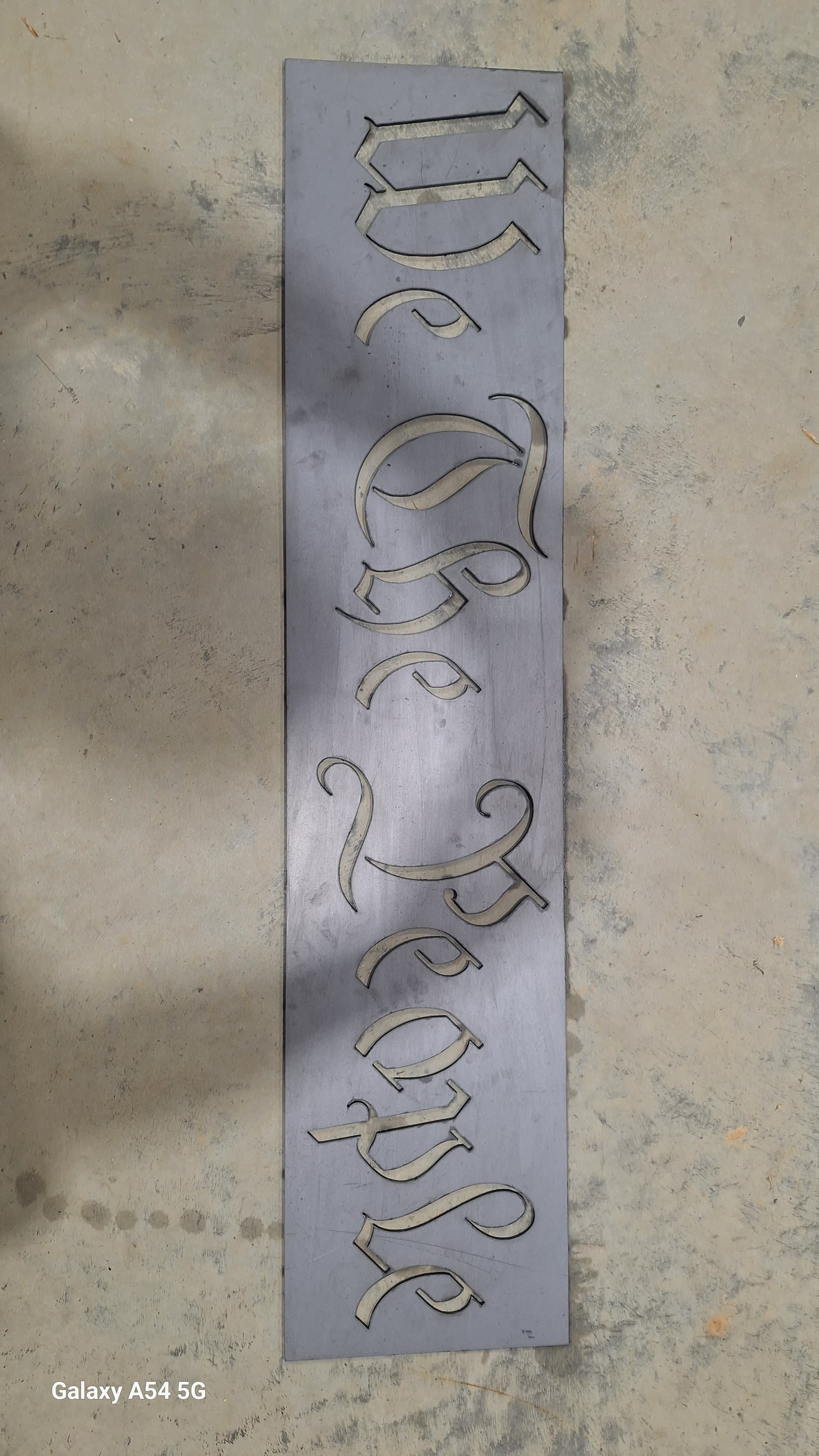

Started with a “we the people” cut.
Cut one fine with a everlast 82i using big daddy’s reccomend settings. 1/8 inch steel with thc.
Second cut was loosing thc voltage measurement And couldn’t maintain the arc. Some cut lines some not cut, beautiful straight lines then missing gaps. Looked like torch passed over with no plasma.

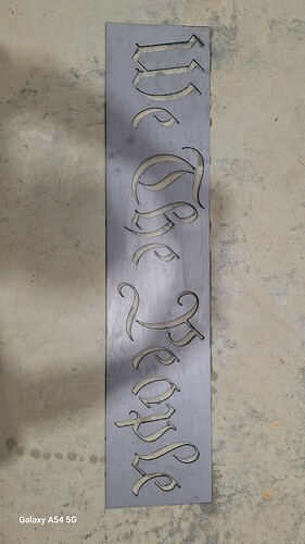

Switched back to the cnc machine and ran another we the people.
Some cuts some not, like the torch shuts off in certain portions. Ran a thc test and torch fired but with low voltage 36 vs 120 ish. Fired another we the people and the torch wouldnt fire.

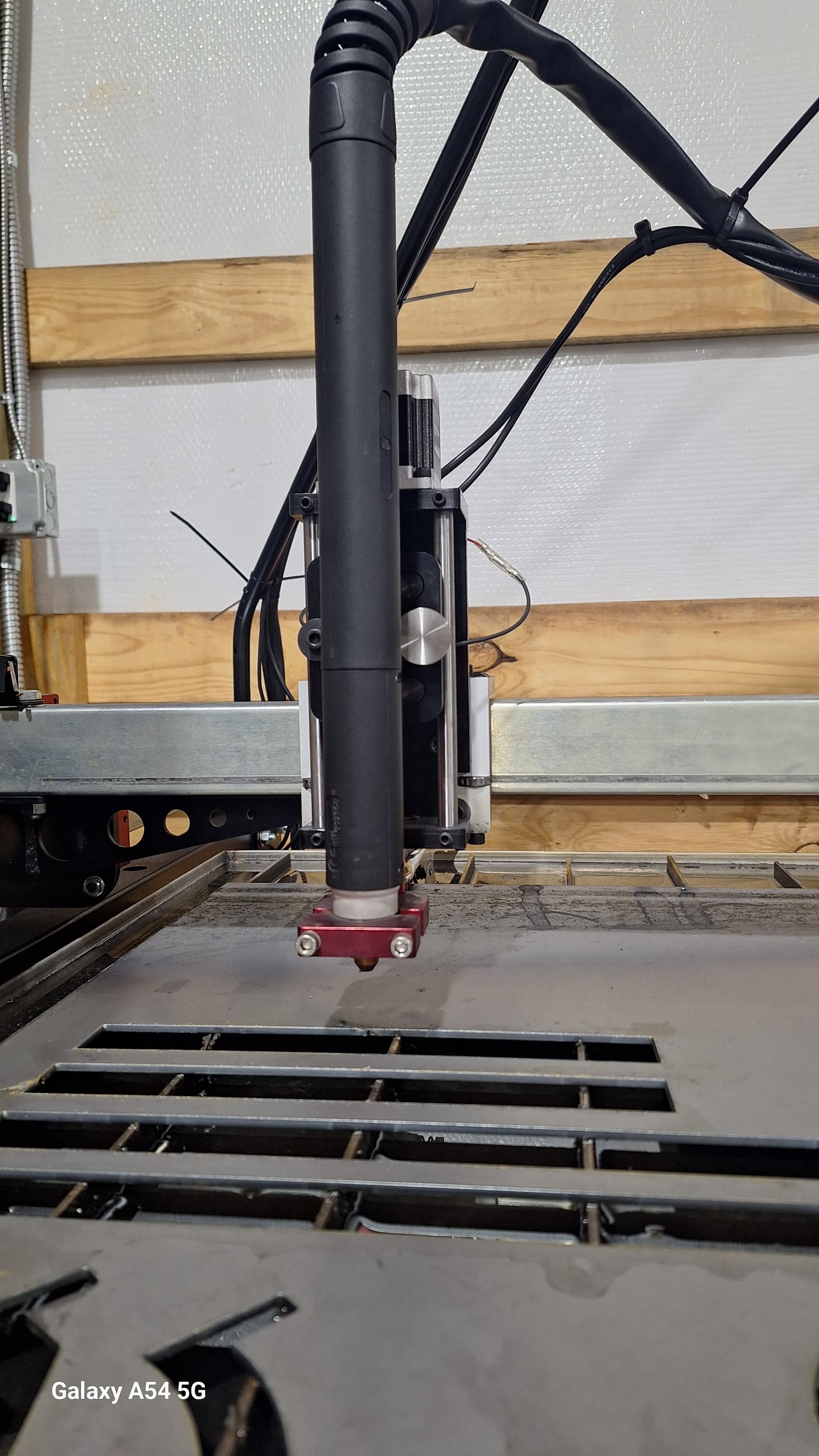

Send picture of your torch mounted on the machine. I suspect an issue :grin:

Well, im definitely clamping in the wrong spot then with the ptm 80. I will send pics tomorrow after work.
Thanks for futher input and time.
Walk of shame I think? Need to build a clamp that goes on the upper housing i assume? Probably grab some aluminum stock tomorrow based on your thoughts.
V/r
You are using the hand torch mount. As you have surmised you will need a different mount for your machine torch. You can order a machine torch mount from Langmuir. There are allot of other options out there as well, I use a 3d printed one designed by @ds690. He has it posted on thingiverse.

Or you can get a round torch holder that doesn’t crush your torch like the V-block style does. The Beck Tools Torch holder applies force all the way around and keeps the torch round and doesn’t bind up the internals. With this torch holder you can clamp on any part of the torch. Just gently tighten the clamp screws. Machine Torch Holder - Beck Tools
