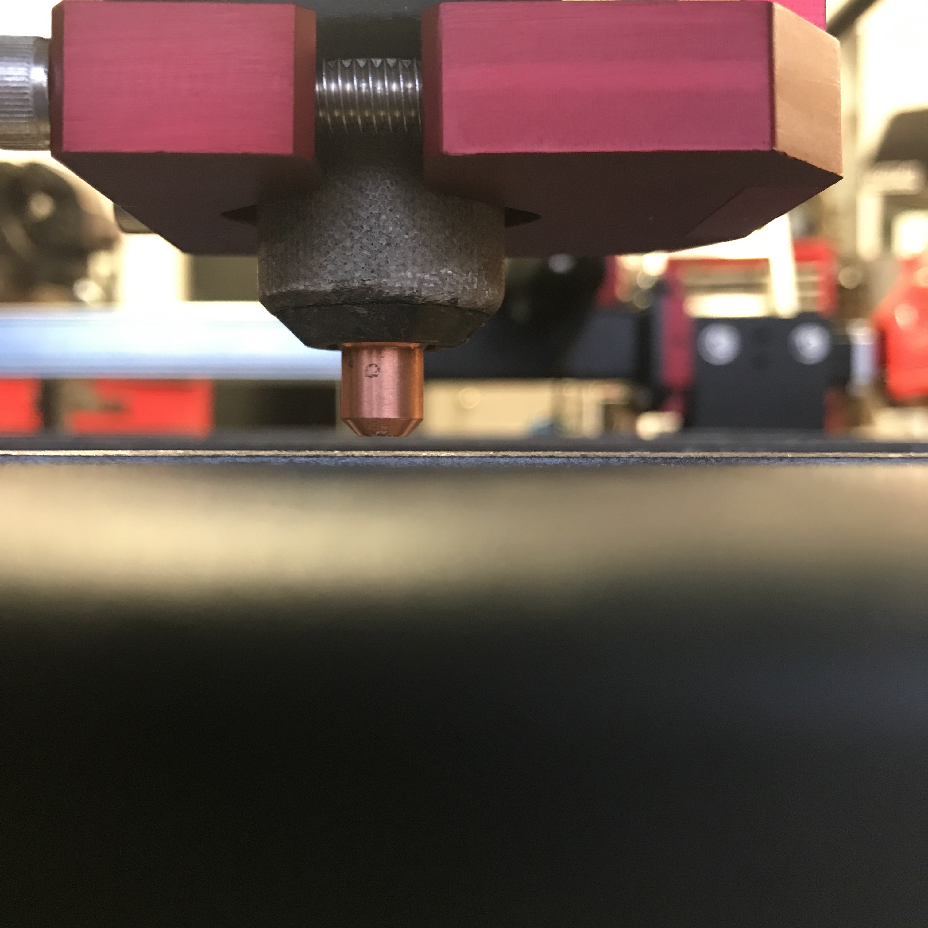

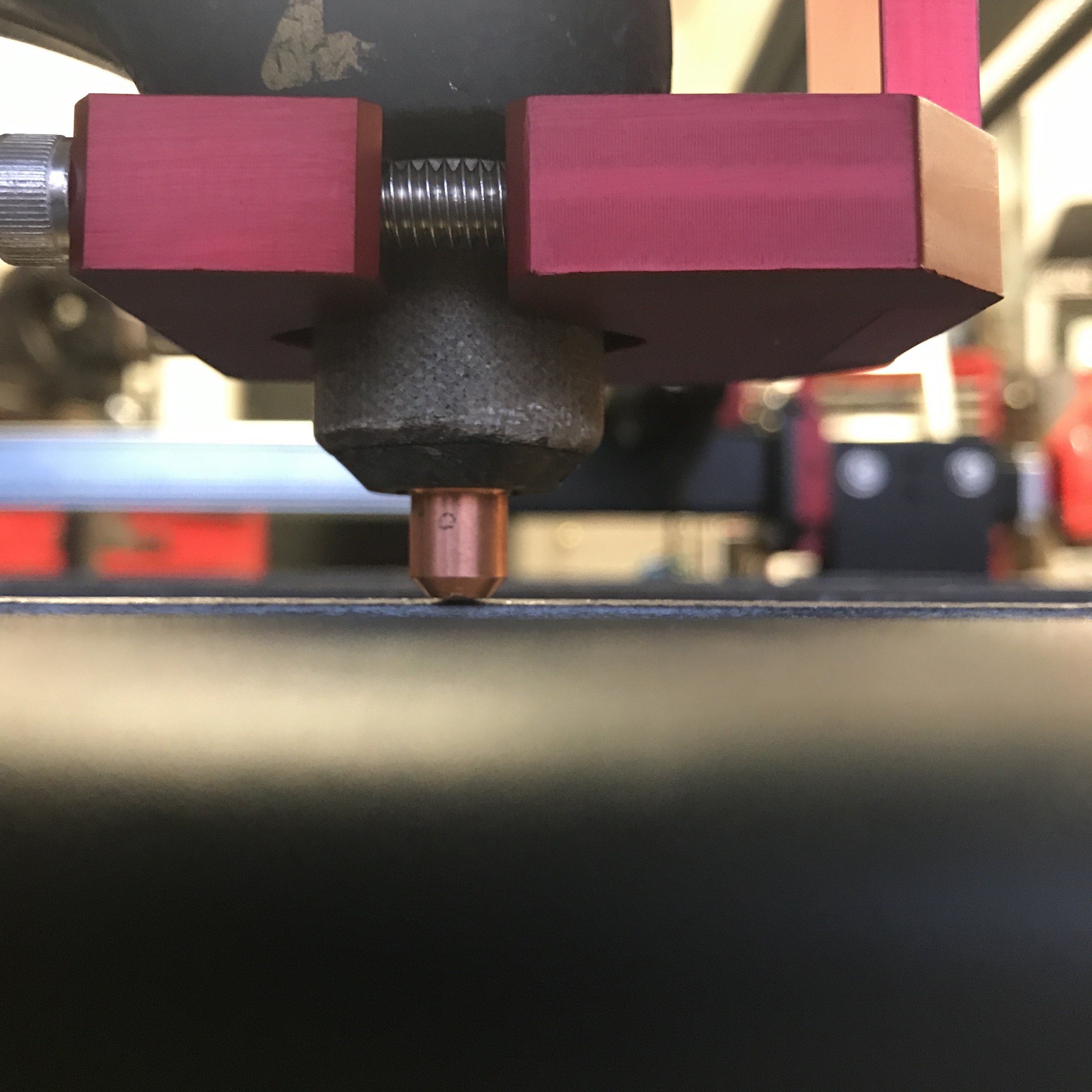

I have had one issue after another with this thing really would like to get it up and going. My slat bed is not level I set the height on the most extreme slat in the positive x direction when I jog the y direction my torch is almost touching the slat if I jog negative x at the end of y my torch will contact a slat in the middle. Not sure if the slats are sheared incorrectly or what. I’ve tried adjusting the casters as the video stated and nothing. Please help Langmuir

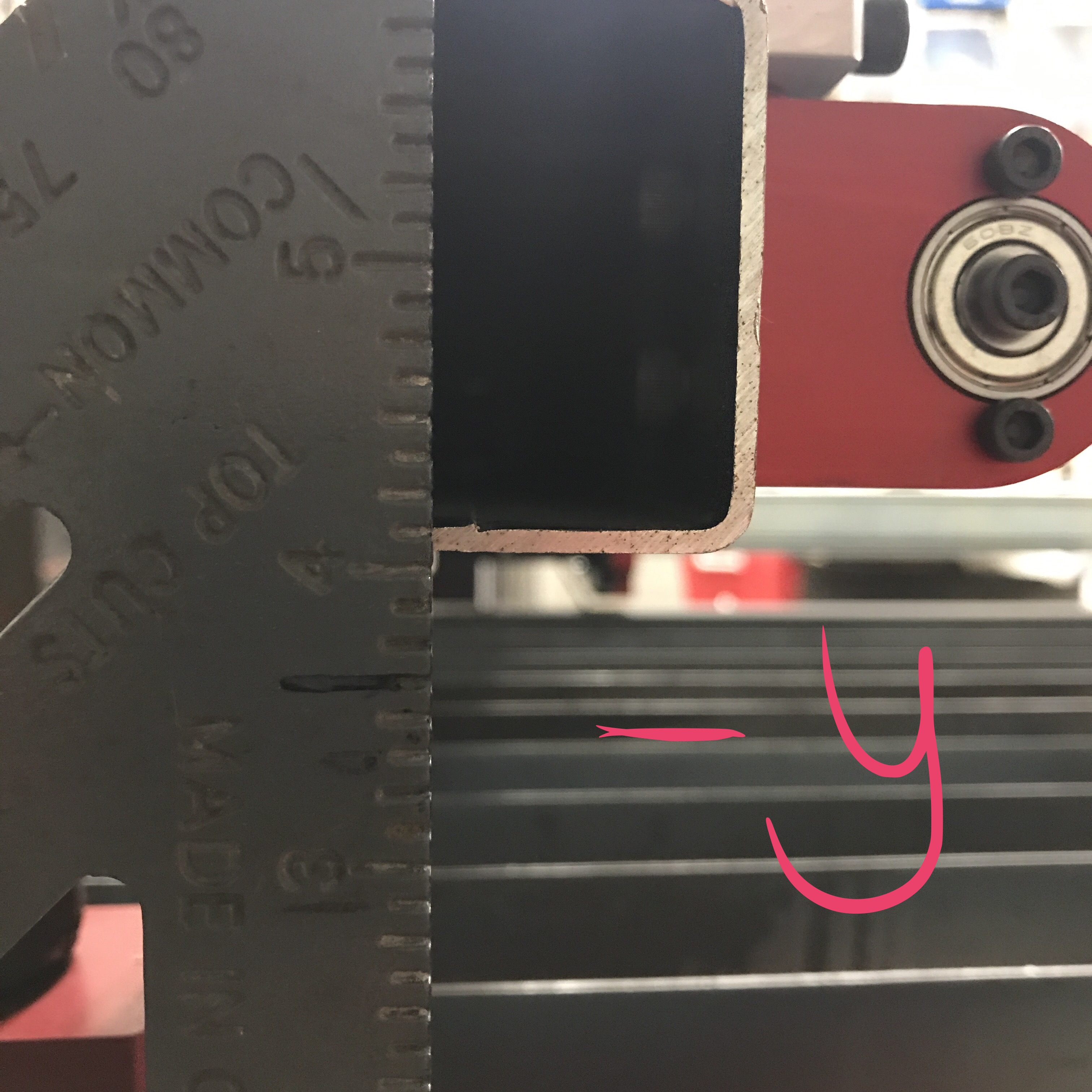

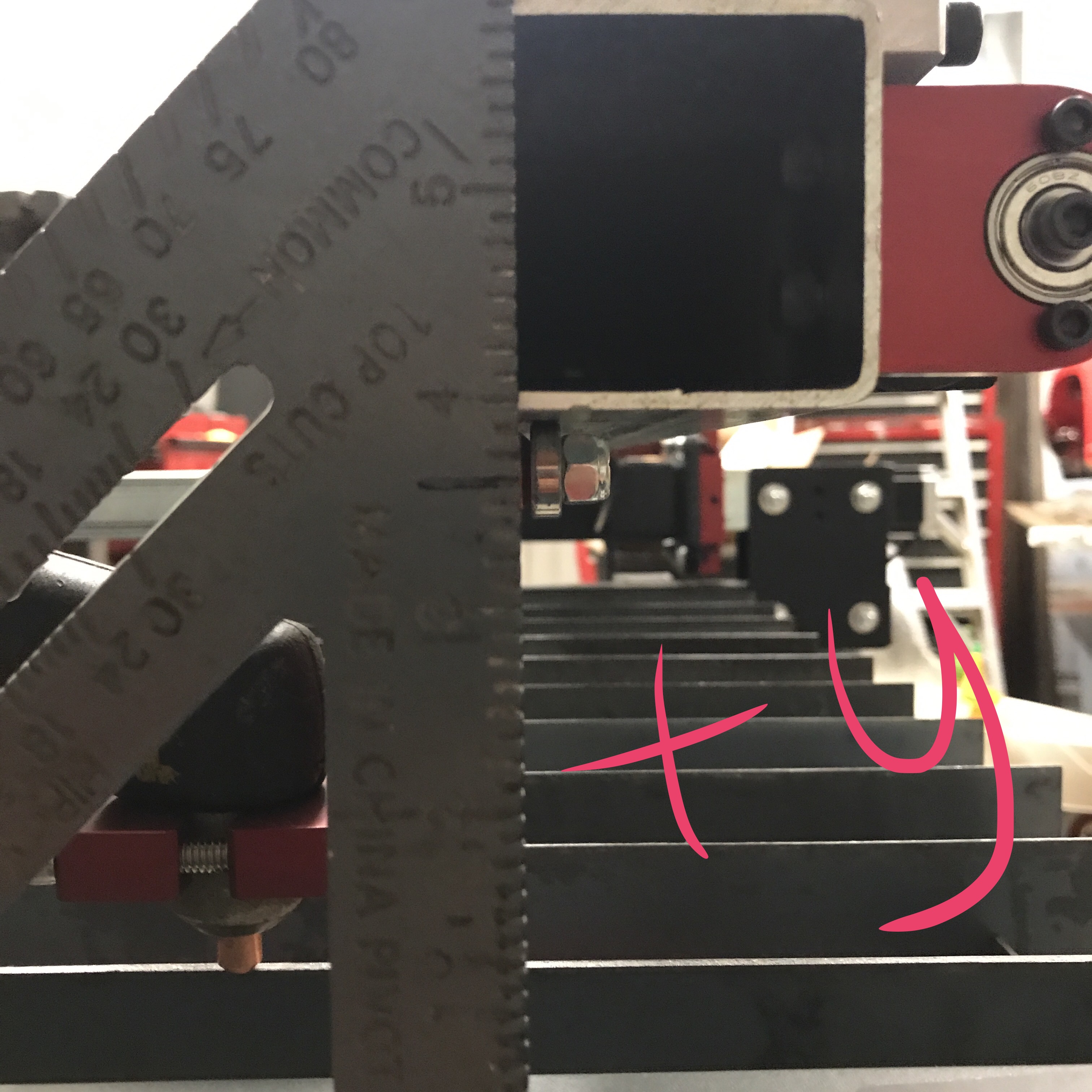

I adjusted the casters all the way in and backed them off two turns loosened the frame bolts so they where still snug. Adjusted the casters and made no difference. The difference between -y and+y is about double. I am beyond frustrated and am about to disassemble the whole unit and start over. I noticed when moving the machine around the gantry height changes,the following pictures shows the difference of just one finger pushing against the unit.
How do I fix this issue the gantry arm is closer on +y then it is on -y this is from the frame to the gantry

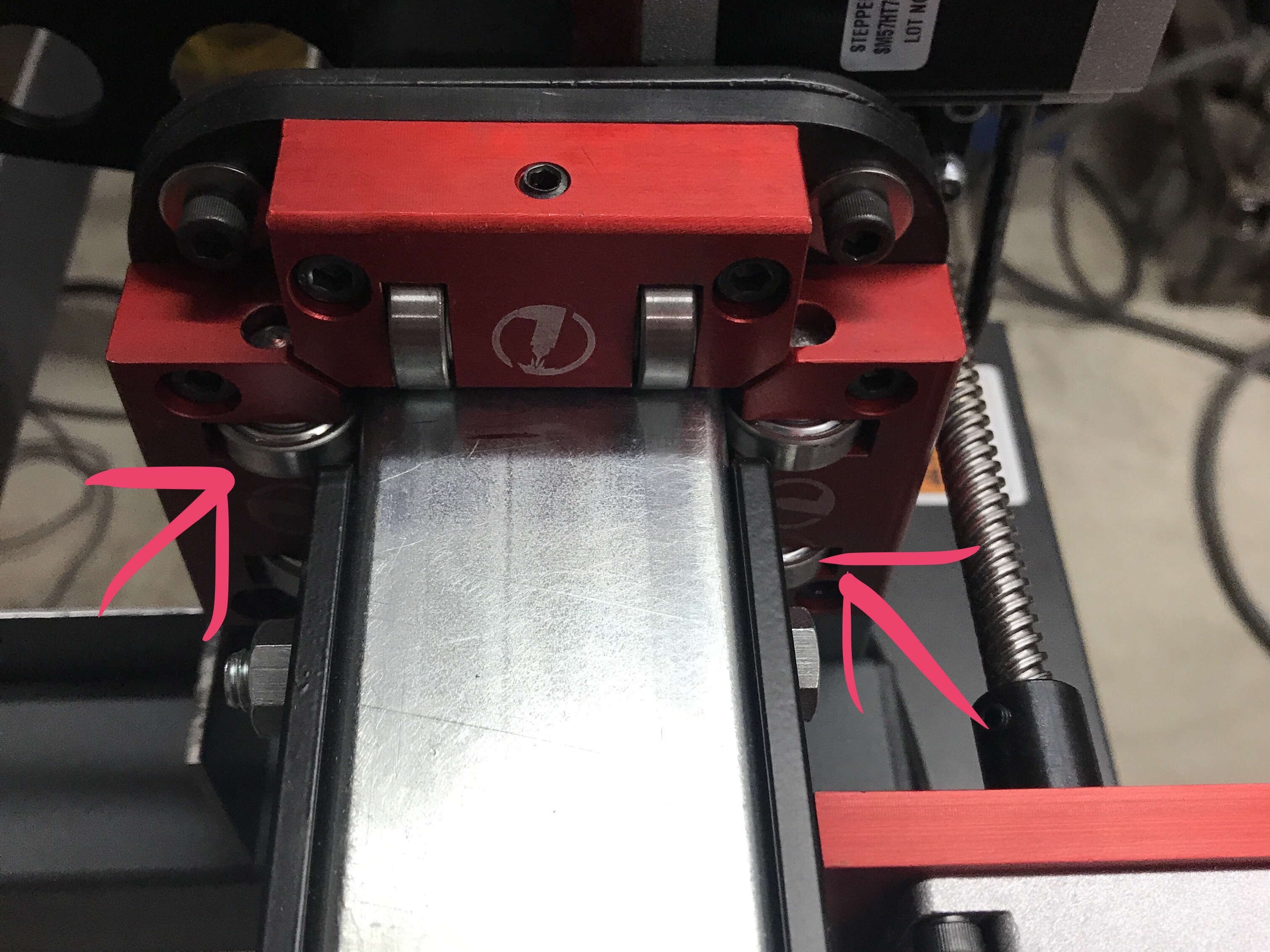

Also these two bearing can spin when at +y
