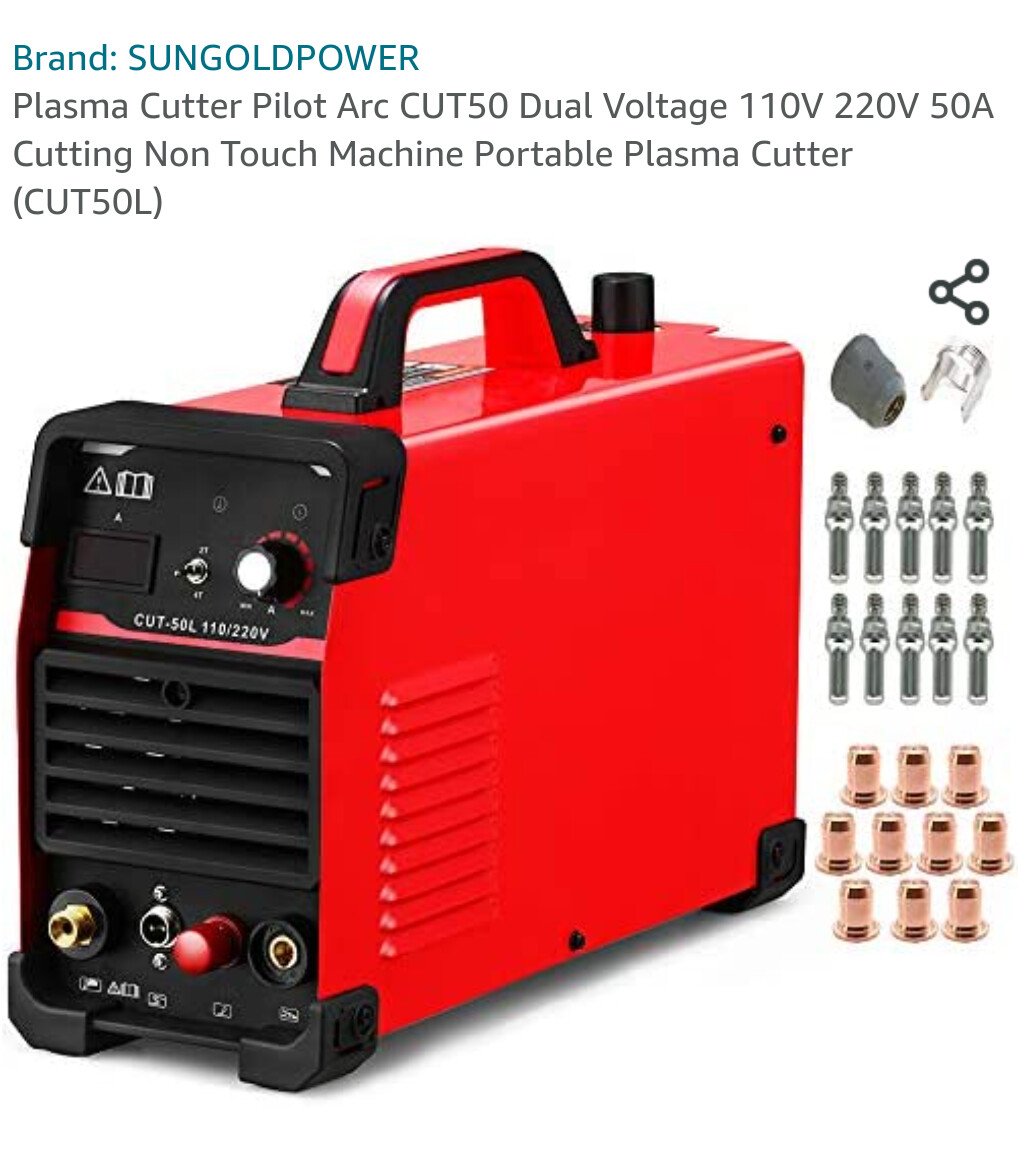

I researched this model number some.
Apparently they are selling it as a low frequency start?
Here’s an Amazon listing
Sun gold power cut-50l
Rebranded version
Dr flo YouTube video on the cut-50l
And Dr flo is running his plasma table with this machine
Is this what yours looks like? maybe a different color.
I’m interested to see how this is going to play out.
Mine looks just like that. However I decided not to risk it after George chimed in. I bought an Everlast PowerPlasma 52i. They said the expected ship date was 8-5-21. It was one of the only machines I could find in this economy.

It makes me think the CUT50L model is hit or miss on the specifications because mine has the HF torch but the one in the pictures above has an IPT torch and specifically says “Non-HF blowback start, there is no HF interference”
