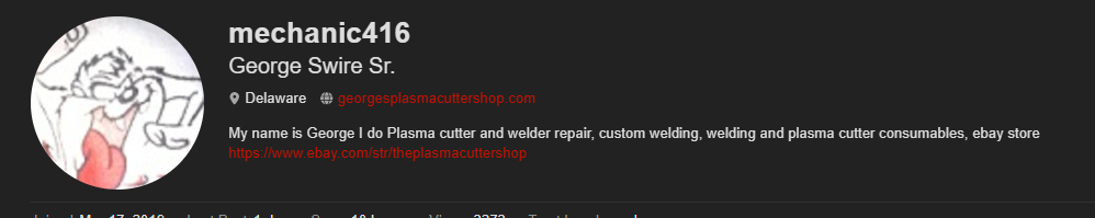

You will not find a more trust-worthy source than @mechanic416. Private message him or ask him directly in this topic. His webpage can be found in his profile on this forum. Just click on his avatar twice and it will take you to his profile:
