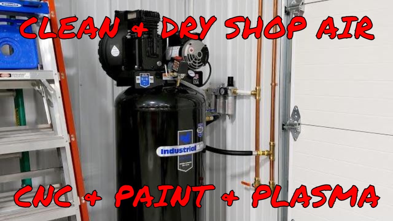

Took all of the advice from here and piped my whole shop. Very grateful to everyone on the forum who gives advice and suggestions.
For anyone interested, here is a detailed overview of my new system.
P.S. I have another 3-stage dryer right before the Plasma cutter. Just didn’t want to show my expensive CNC machine to the public.
