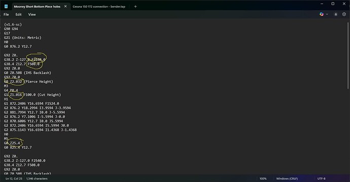

When he posts his g-code, the actual values for pierce and cut height change from that of his programmed values.
This isn’t a metric/standard conversion issue as he figured that one out right away, and his feedrates are correct.
Only his pierce and cut heights are changing.

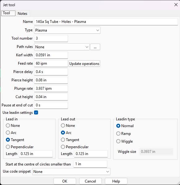

But if it matters, he had posted a screenshot showing his parameters, and then what actually spit out in his file.
I believe this screenshot was before he figured the conversion part being done, as it now runs at the correct speed.
But the cut and pierce heights are still being spit out differently.
In sheetcam when you change a tool and close sheetcam it will prompt you to save. This is the only reason I can see it not saving.

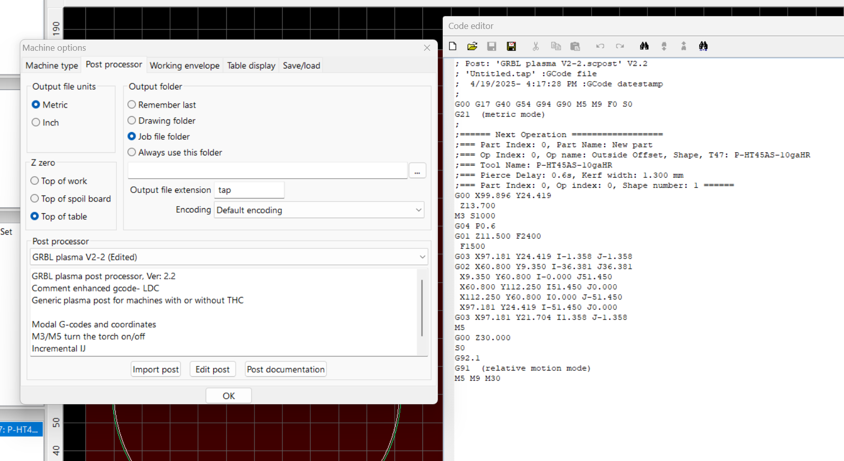

Sheetcam needs to know where Z has been zeroed at start of job. See menu Options-Machine-‘Post Processor’, field group ‘Z zero’. Normally for plasma process, zero Z at ‘top of work’. He most likely inadvertently changed this to ‘top of table’. In top of table case, then ‘Thickness of material’ setting is added to pierce height and cut heights.
In this example, material thickness is 10mm, pierce height is 3.7, cut height 1.5mm

The height values in the code are metric translations of the values in the settings screenshot. 1" equals 25.4mm.
Look at line 4 in the code - G21 metric
Chiming in to say the issue has been resolved.
It was indeed the Top of Table and Top of Work that were switched.
