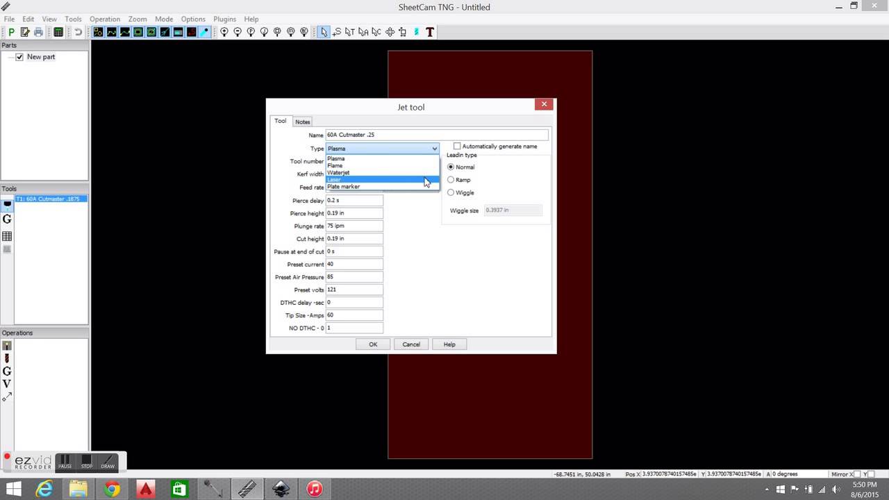

Sheetcam setup question
Hey Joe!!
So, you will want to set up tools based on the type of material / Amperage you’re cutting at / Thickness of material / Etc Etc… You will probably go in and adjust from your initial settings after doing some test runs and tweeking a little here and there as you go. (No problem to edit a tool once it’s been created)
Here’s a link to an older video but, I think it’s all still relevant.
