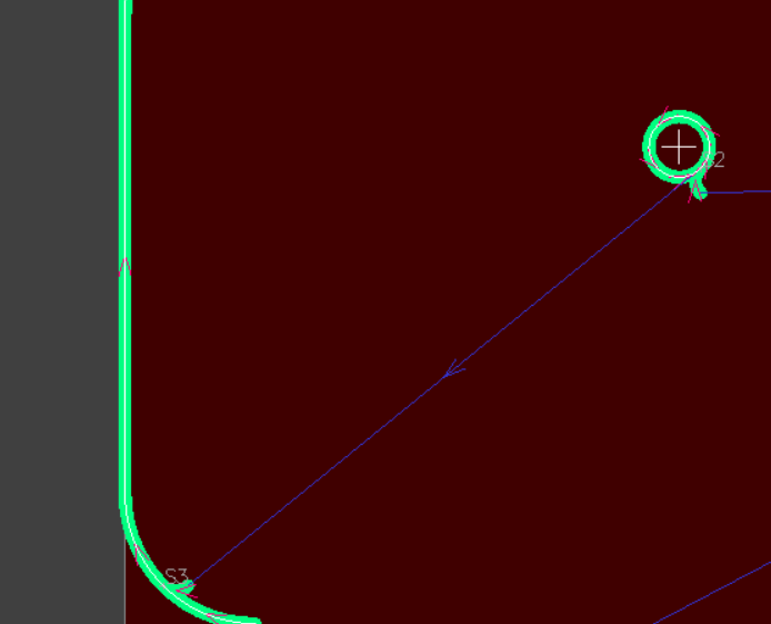

I had a recent HDD crash and lost my settings. After installing and setting up SheetCAM on the new drive I have a couple of odd issues that I can’t seem to find a solution for.
First is the display of the work area and the red which I assume is my work area. The red is offset from X and Y zero and very small. I set Machine Options working envelope and table display to my Crossfire size of x = 25.3 and y = 33.3. Below is snip of what I’m seeing, part is roughly 9 x 9 inches.
Second is my lead in is backwards, starts inside the part and outside the holes. Any help is greatly appreciated.
Okay finally got it. Job options - material tab. Set the size and xy location.
Plasma cut operation - Contour method - outside offset.
Thanks everyone.
