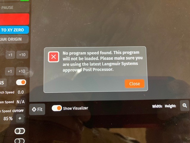

I am trying to cut a from a file that I posted from Sheet Cam. This is the first file that I have run through sheet cam and have program speed error. Any ideas. I am running the latest fire control post file.Firecontrol%20error
something tells me you did not install the post program into sheetcam that allows sheetcam to postprocess a tap file into the proper commands for Fire Control
https://www.langmuirsystems.com/software/sheetcam
Thanks for the quick response.
I have FireControl-v1.5 scpost and FireControl-v1.6 scpost pasted into the SheetCam - Posts folder
Ah, but did you select either one of them when you setup your operations, specifically, you need to select
Options->Machine->PostProcessor and in the PostProcessor listbox, choose the correct FireControl post.
