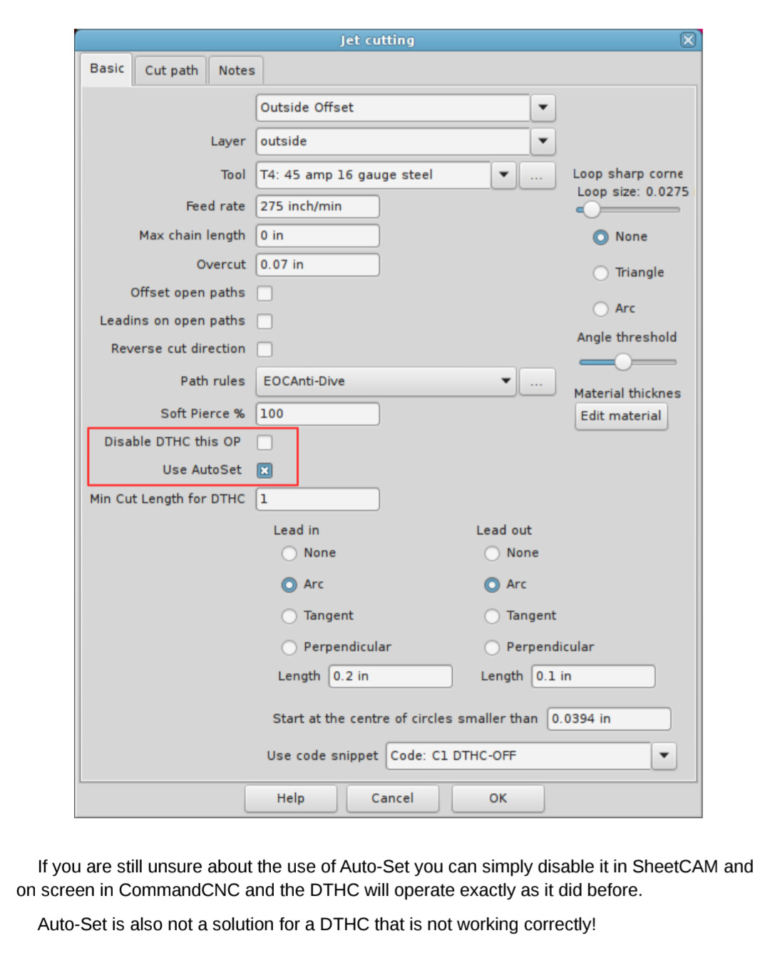

Ended up being an issue on the program….I needed to turn on DTHC Auto…I do not know how it even got turned off. Just posting an udpate.
I’ve never heard of that setting in sheetcam. Where is it?
It would be interesting to see the G-Code file of when you’re having the issues and the g code file after you modified it with this setting.
Could you post the *.tap file that you are having issues with and then post the *.tap file that was successful after you modify the setting?
I agree, having the two .tap files would be useful, but looking at this dialog, I wonder what EOCAnti-Dive does! :grimacing: :thinking:
It turns off the THC during torch slow down for different elements. Same function that’s built into firecontrol with the 85% THC cut it off.

So this is the newest version of sheetcam? I’ll run two files and post them.
I’m going out on a limb here and I’m going to say you downloaded a job file or a tool library from somewhere yeah?
It’s definitely the Sheetcam version 8 that you have to buy a new license to get. I have the latest version 7 and this option doesn’t exist.
There is no way that DTHC option will put the proper Firecontrol THC commands in the code.
I’m curious as to why you say that. It seems you can just leave out the H1/H0 commands and accomplish that.
The Firecontrol post processor adds the H1/H0 commands, as long as there is a pierce height and cut height entered in the tool. Those just enable and disable the THC. Disabling of the THC during slowdowns is software controlled by Firecontrol. The default is THC off when speed falls below 85% of the program speed.
Any additional THC on/off commands added by Sheetcam will be redundant or cancel each other, even if they use the H1/H0 commands. Most of the THC commands that I have seen added by path rules or code snippets are in a format that Firecontrol doesn’t recognize.
AND the dialog in SheetCam is not set to THC disabled. This isn’t magic. The SheetCam dialog provides settings to the Firecontrol PP - it’s just another control. This, of course, requires an updated PP but SheetCam is perfectly capable of making that change.
Which is why it would be nice to see the code with and without that option selected. Very few of us have used the new version of Sheetcam, so we don’t know if deselecting that THC option has the effect of triggering the post processor to remove the THC on/off commands.
Which is WHY I challenged your claim
We just don’t know what it does…
