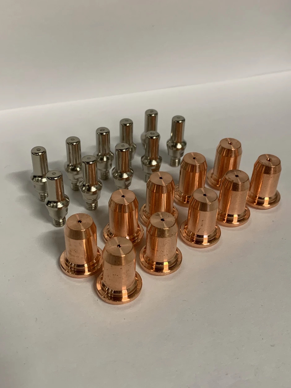

0.9mm tips are rated at 30 amps minimum and 40 amps maximum and should be run at about 65/70 psi.
I didn’t know gamblegarage sold Tecmo IPT consumables only Trafimet S45 that are not for the Primeweld cut 60.
good to know about the PSI. I was just going off the chart in the manual for 16 gauge. I will try to up it to see if anything changes.
Yes, gamblegarage sells PT/IPT60 consumables. I bought a set to try out. been good so far but will get a couple from your shop to try out as well.
