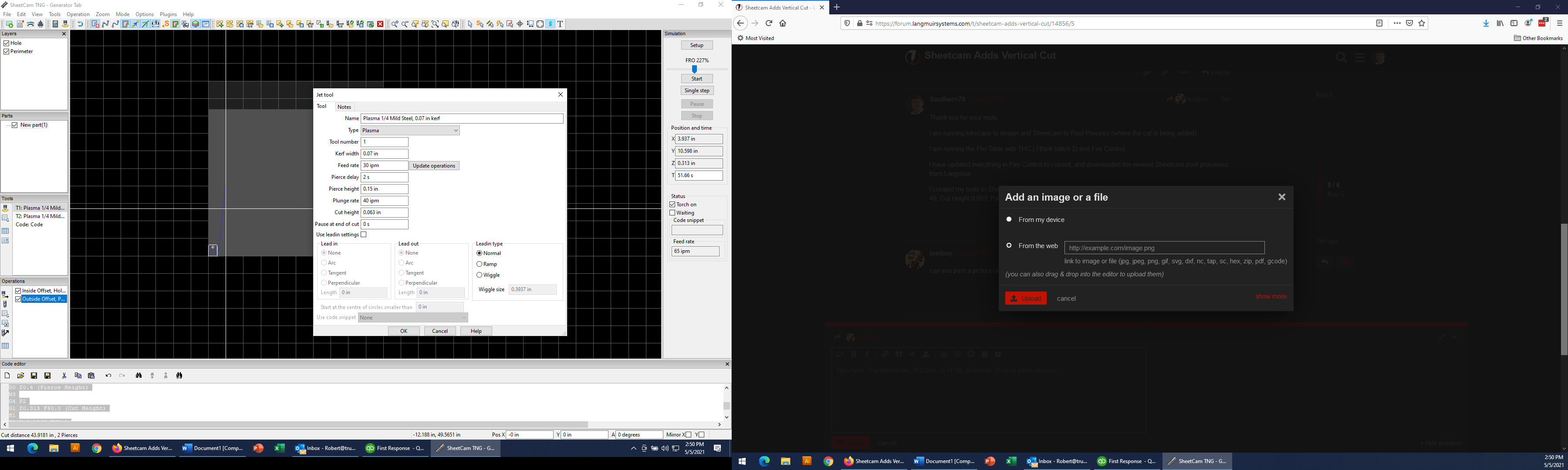

After I run the post processor (updated) Sheetcam adds a vertical cut the height of the material. The jet cutter moves vertically to the right and wants to cut a vertical line. I am not sure why this is being added or how to remove it. Any help appreciated. Thanks!

What does it look like in sheetcam itself? If you don’t see that line in the preview then it’s a sheet cam setting. If you do see the line, it’s something with your drawing.
In Sheetcam the tab is all that I see until I run the post processor. After processing the line is added.

I created my tools in Sheetcam ie: Tool 1 - Kerf .07, Feed 30 IPM, Pierce 2s, Pierce Height 0.15 in, Plunge 40, Cut Height 0.063, Pause 0
can you post a picture of one of your tool settings…
problems I see to start…
you are cutting 1/4"…your speed seems way to slow…I am cutting 3/16" at 60ipm
why is your plunge rate at 40?..should be more around 3 to 4 ipm
my pierce delay is running at 1.5 seconds

Also, zoom in when working in Sheetcam, it gives you multiple options to view the part, view the whole work piece etc. It’s very hard to see the tiny view of the part and movement path in your screenshot.
