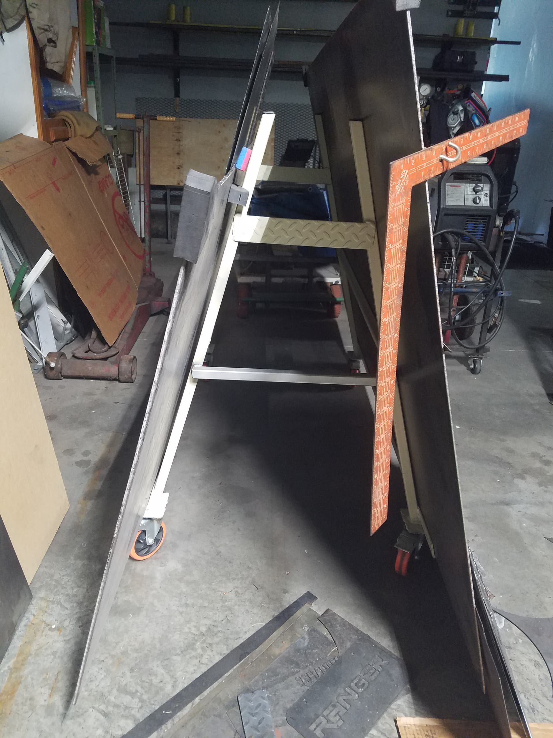

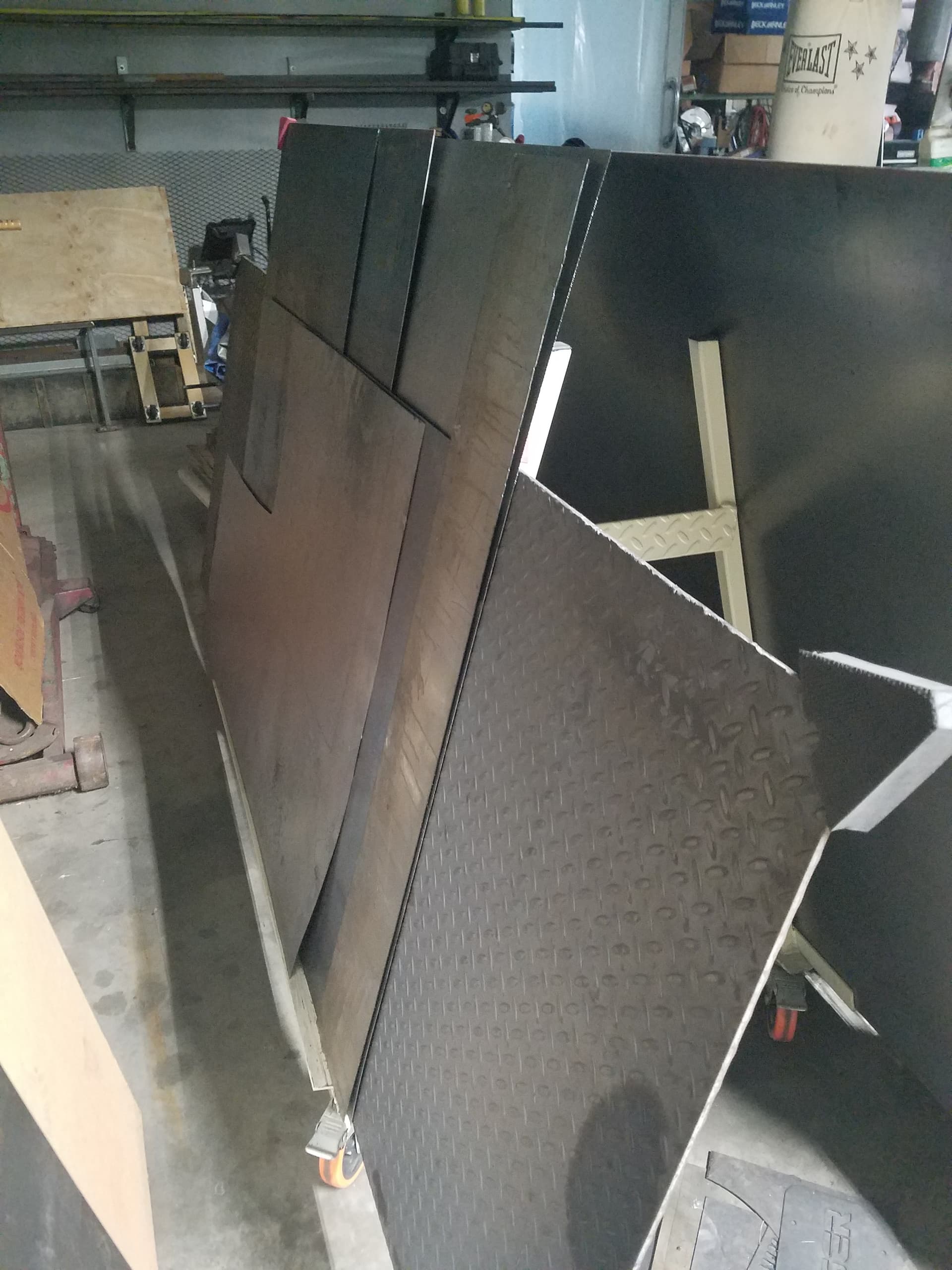

I made a basic rolling a-frame rack out of 1" tubing and some 2" x 2" angle. It’s worked pretty well.
Ignore the messy surroundings. I’m gonna get it cleaned up later today ![]()

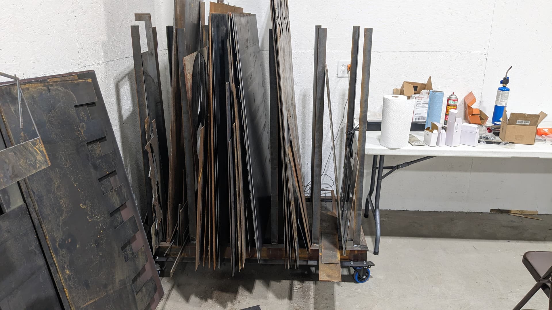

Made this out of some drop channel from work. Put the wheels on so it was moveable. Hasn’t moved since I pushed it to the corner
@Madman This goes to show that even with an elaborate storage system you cant beat the wall-lean method!!
