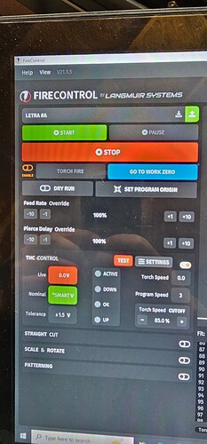

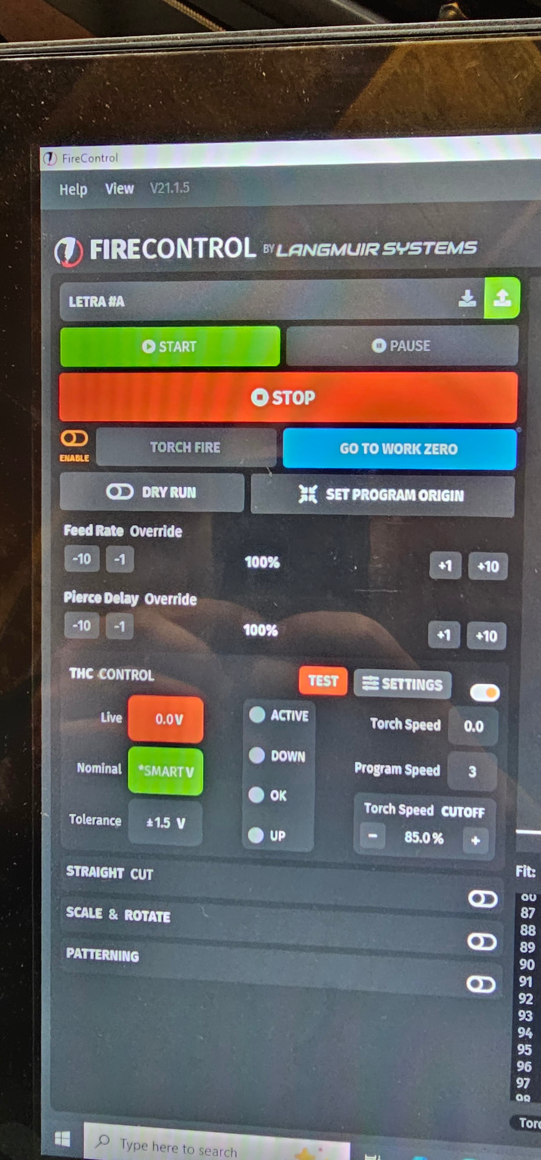

Hi. I’m new to Sheet Cam. I made some designs, but when I try to cut them on my Crossfire XR, the torch moves very slowly. Has anyone else had this problem?
You have a program speed of 3 I assume Ipm . What are you cutting and what do you have the speed set for the tool you setup?

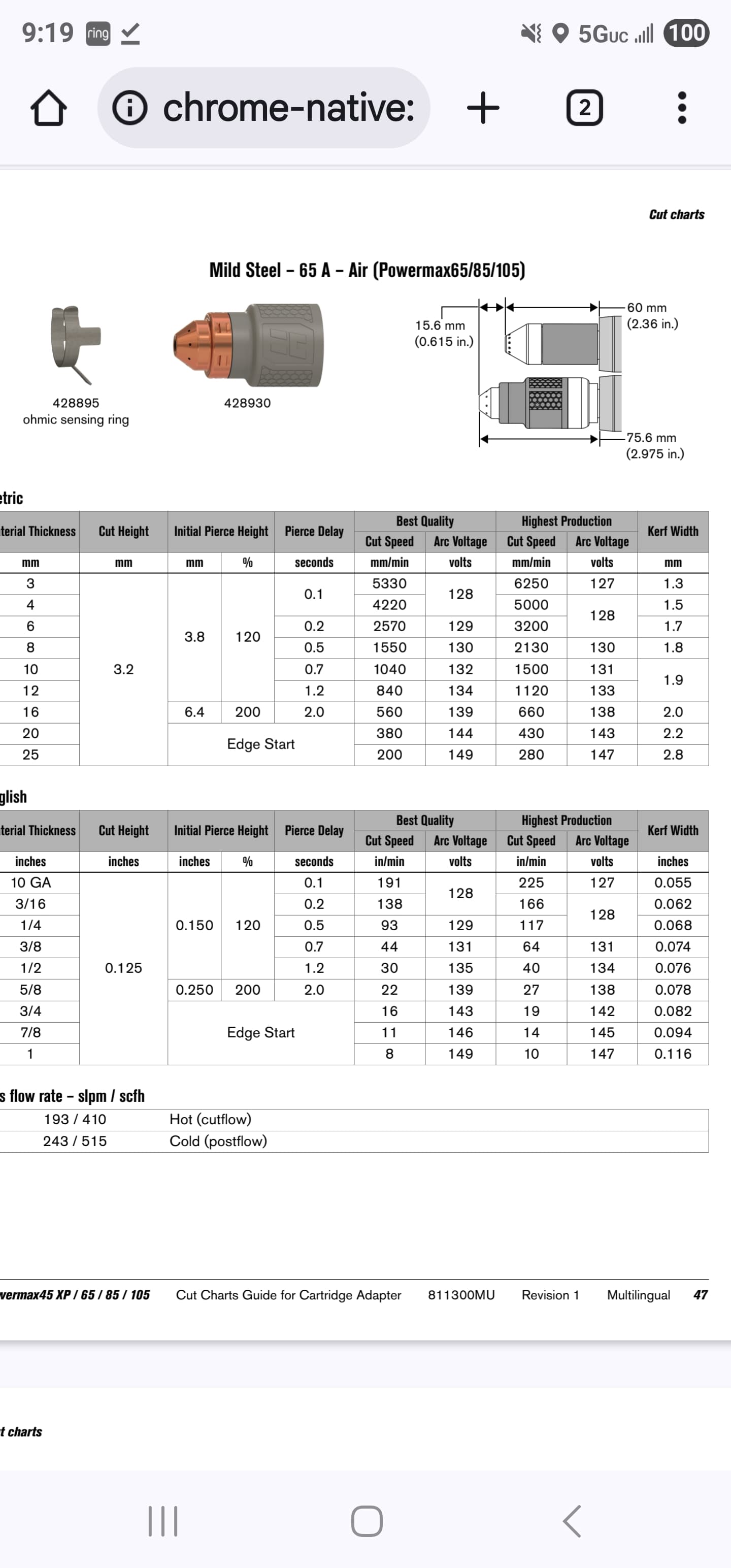

It’s for 3/16" material. I configured it in the sheet cam following the Hypertherm 65A specifications. But it seems the speed isn’t correct and I’m not sure what parameter I should change.
Do you have a cut chart? You go to the tools set select the tool you have for 3/16. Change the cut speed. Off the top of my head you should be 120 to 150.
According to the Hypertherm 65A table, the speed cut is 138 in/min. but my torch still moves very slowly.

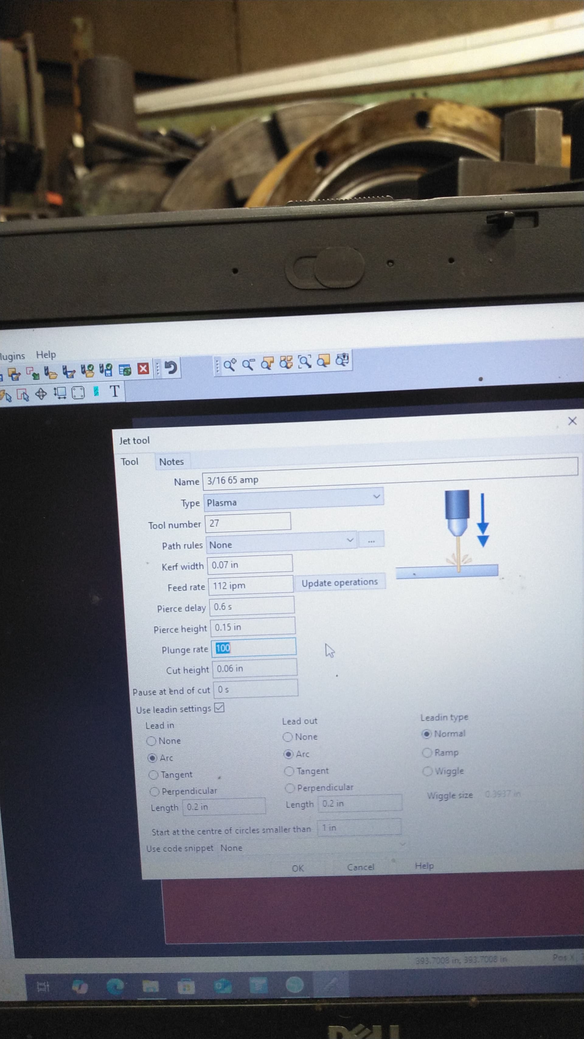

You have to change it in your sheetcam settings. I will post a picture of my toolset. Arclight has great YouTube tutorials on sheetcam. I recommend watching them.
Here is my 65 amp 3/16 tool. Keep in mind hypertherm recommends a slowdown of 20 percent using a water pan. That is for non sync which I have. You will need to adjust the plunge rate as well if you haven’t done that too.
Had to do a picture I don’t have Internet service to do s screenshot.
Thank you so much for taking the time to answer my questions. I think that’s my problem. My plunge rate is 3.4 or something like that, but I wasn’t sure what its function was. Thanks.

You are welcome. Plunge rate is the rate the torch moves from pierce to cut height.
I do not have a tool for fine cut. Hypertherm is spot on with their charts. The only exception I can’t say about the sync models I slow down 20 percent because of the water pan. They made the cut charts using a downdraft table.
