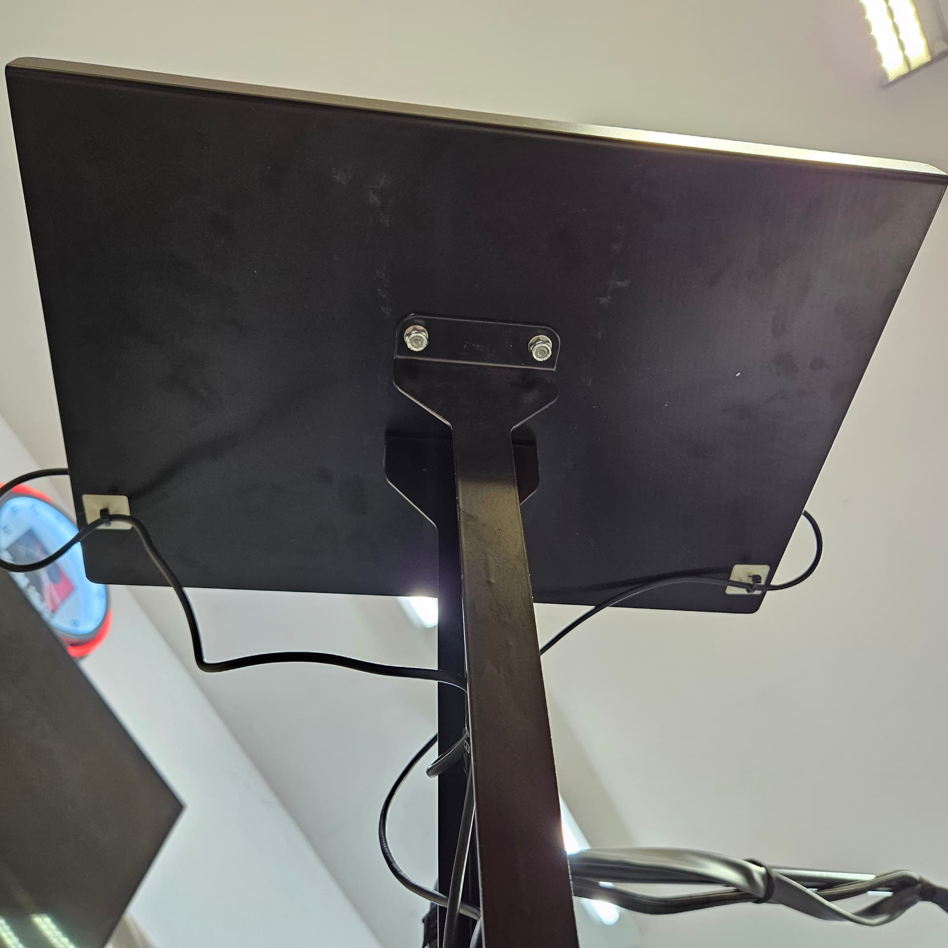

  1. raise laptop top (i am 6’2"); also added o-rings to the ‘axle’ for nicer feel/movement and hold.
  2. integrate laptop PSU into table; including ycable so I only have one 110v plug required.

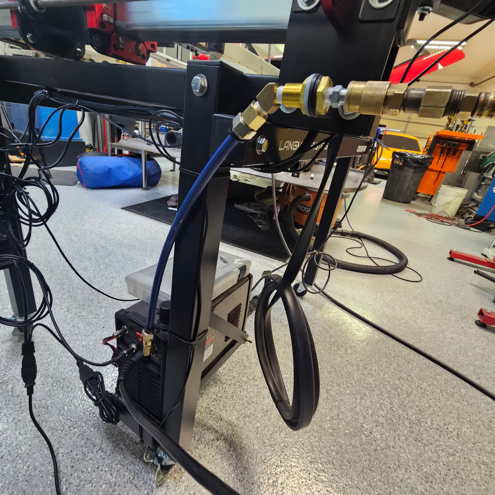

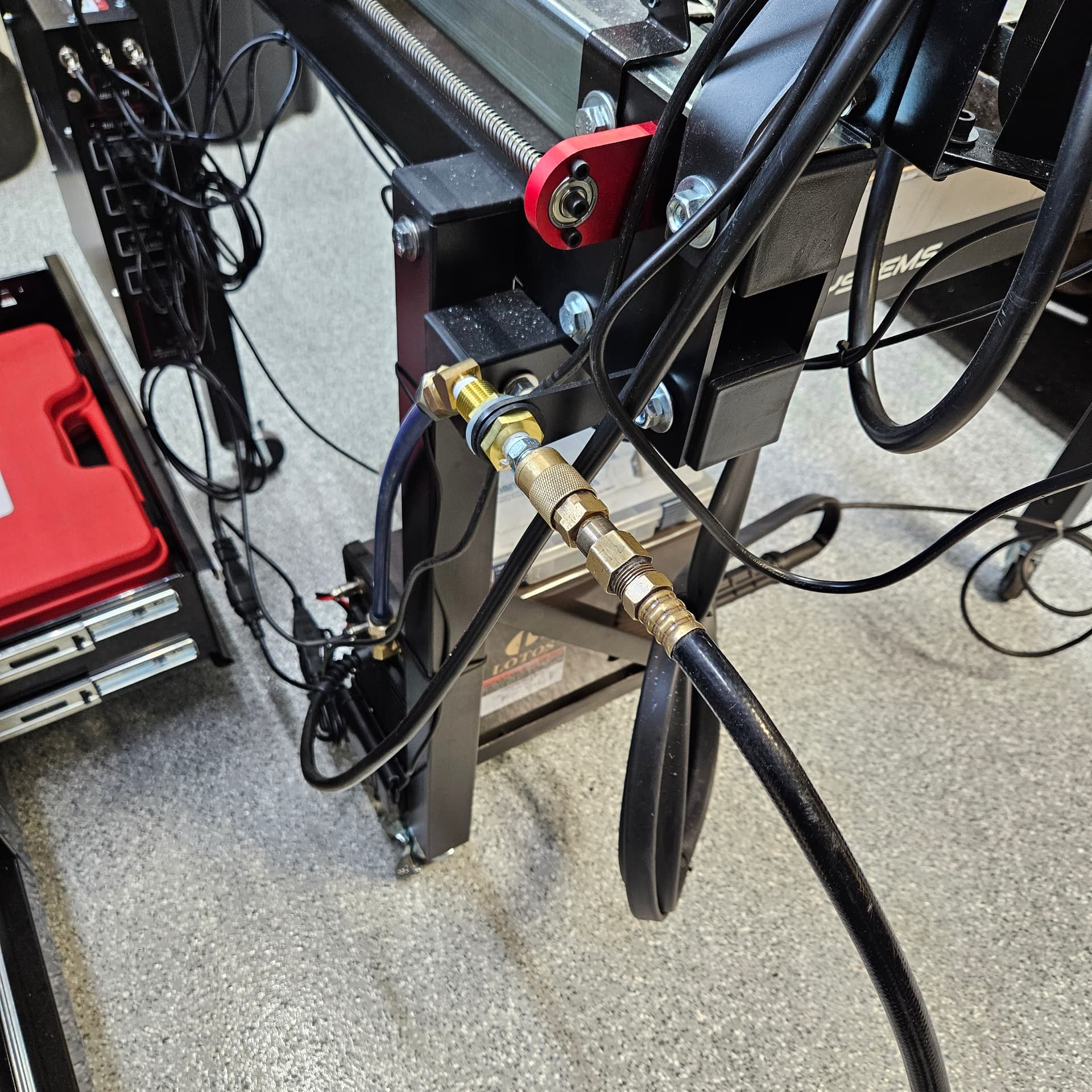

  3. move airline up for easier changes

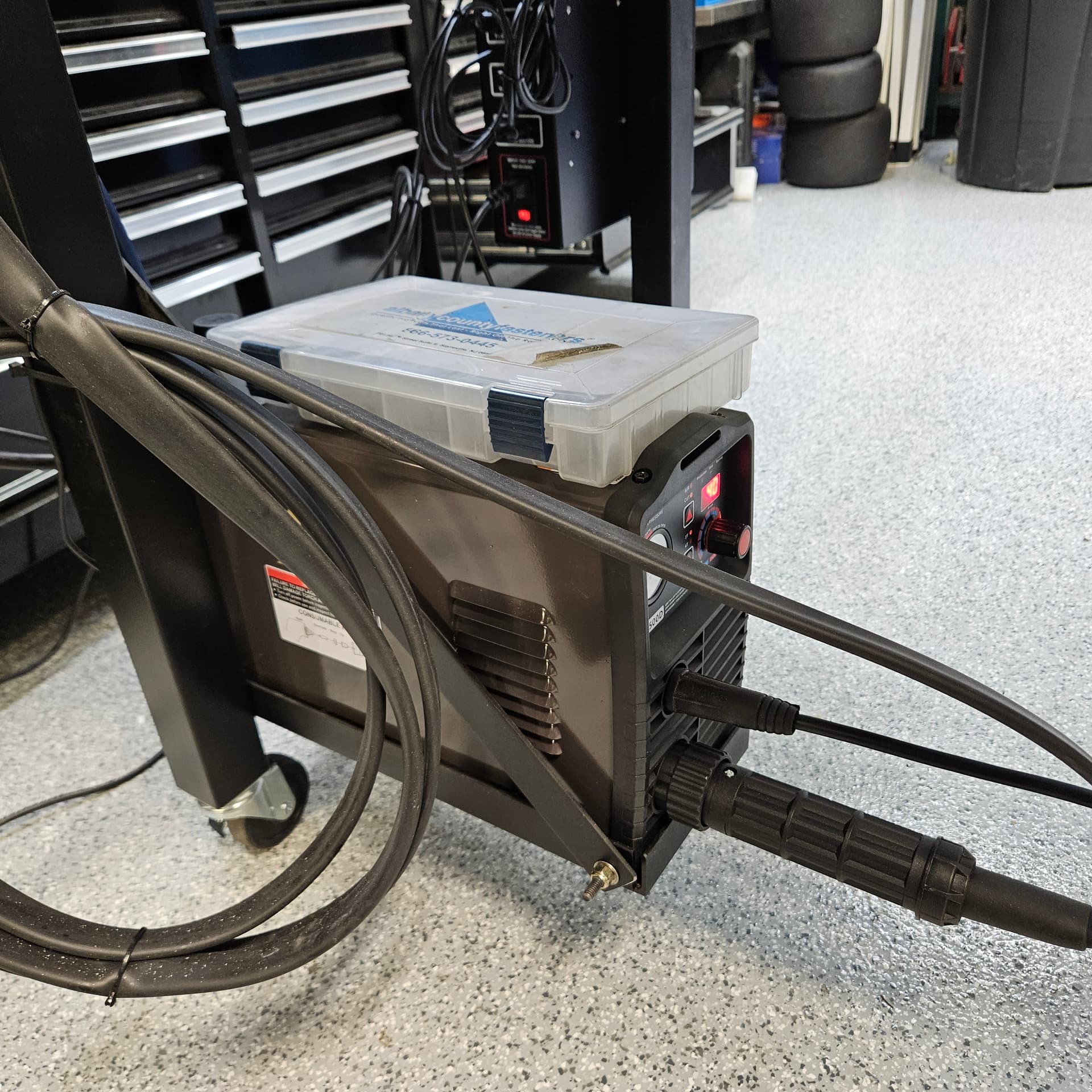

  4. small shelf for plasma cutter; i also removed the handle so my plasma consumable box sits nicely.

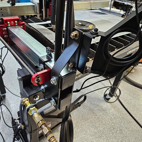

nice work…but I have one sugestion…putting wheels on the legs of the pro…and also mounting your plasma cutter on one leg is adding stresses to the table frame that will most likely cause your table to slowly go out of square in the next couple of years…
How do I know this…?
My table went out of square and I had to rebuild the whole table.
the legs are part of the rail system and putting stress on the legs will put a huge stress on the fame as a whole.
think of a level and a pivot point…the legs are on the long side of the pivot point thus giving it hige force advantage over the short end…that is what is going to happen to the table frame.
think of when the table is cutting…it jerks around a fair bit…the vibrations can get pretty intense.
If you are tall you would be better off building a rolling platform with wheels and leveling legs to put the table on…I did that and it made all the difference…
not only is the table higher but it is easier to move…provides a storage area…
here is my rough repair done to my table after I remobed the wheel and built a base…
Interesting I had not thought of that, but it makes sense. Note it comes with wheels, I didn’t add them. I think this was a change recently for the CrossFire. Easy solution would be to tie the bottom of the legs together. Not sure its an issue for me though due to light weight material I cut.
The plasma cutter is very light, about 15lbs. I also only cut light weight material (heaviest would be a 2x2 .125thk steel plate).
ill keep an eye on it!
I did not see that it was the OG table…so there is less chance of this as there is no extra Y rail…
so my bad on that part…the Pro table is at serious risk for this as each leg runs through the Y rails…
you do not clean work…that is clear…
although it is minimal…but putting the plasma on outrigger like you have does put forces of around 30 to 55 lbs on the top of the leg strut and the rail…you are slightly forcing the leg outwards at the bottom.
to reduce that force run a struc from the bottom of the rail right down to the corner of the plasma support…this will distribute the weight better…
Yup, definitely. Thanks for the heads up. Would be easy enough to tie the legs together at the bottom!
