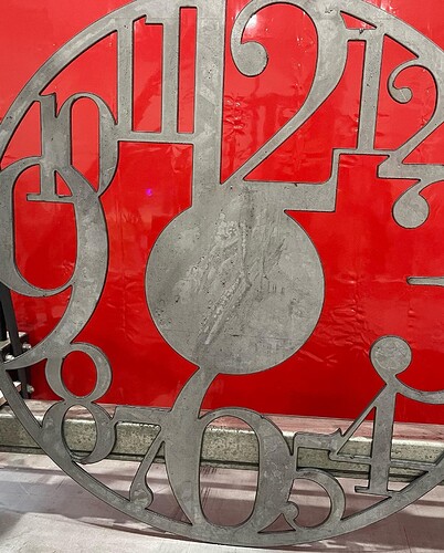

Just did a cut yesterday, vey good but tiny tiny nub burn throughs where the torch stops on the profile cut or the lead out. In FUSION360 that ive been using for 6 years setting a 10-20 ipm feed rate higher on the lead ins and lead outs completely eliminates this…

Yes. You can set a path rule for the lead-in and/or lead-out to have a faster or slower feedrate by percentage of the program feedrate. You can set them in either the tool or jet cutting operation screens. I made a short loom video of how to do that here: Loom | Free Screen & Video Recording Software

I cut this 24” clock from 10Ga
Just ever so tiny nubs of burn through where the torch finishes the profile its on… some would just say its plasma but if i can get it completely clean in FUSION360 i figure Sheetcam should also🤣
