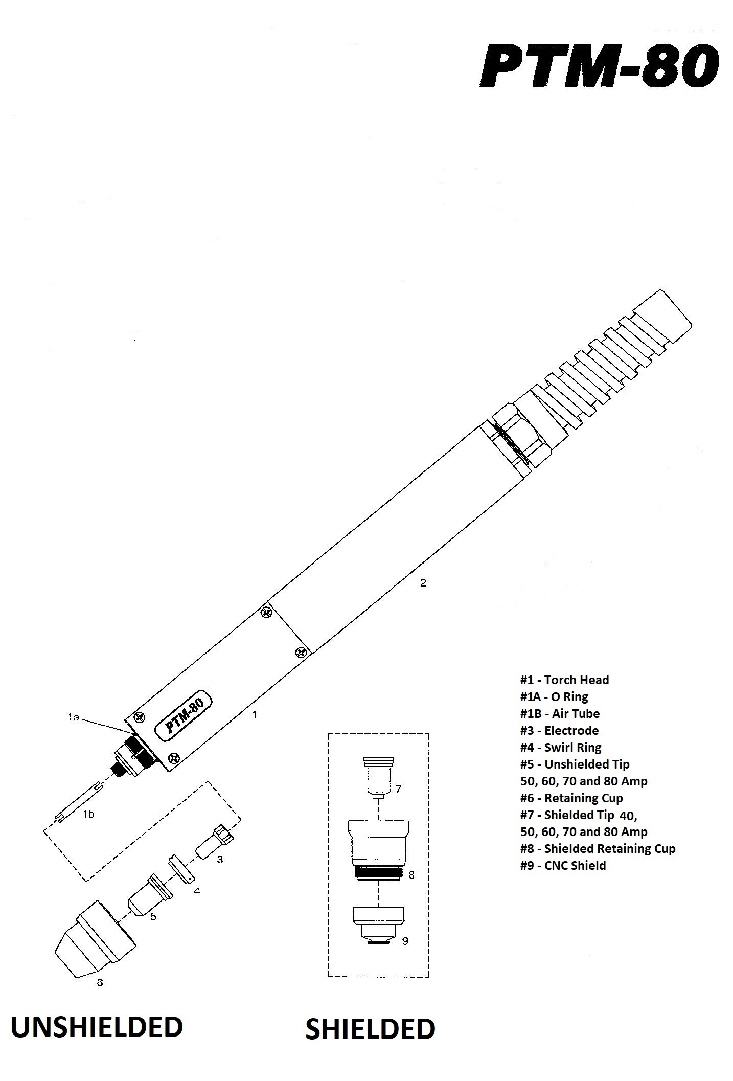

You may also want to use quality shielded consumables for better results. If so let me know.

I went to shielded consumables from George and will never go back. Night and day difference, especially with aluminum. Just my two cents.
