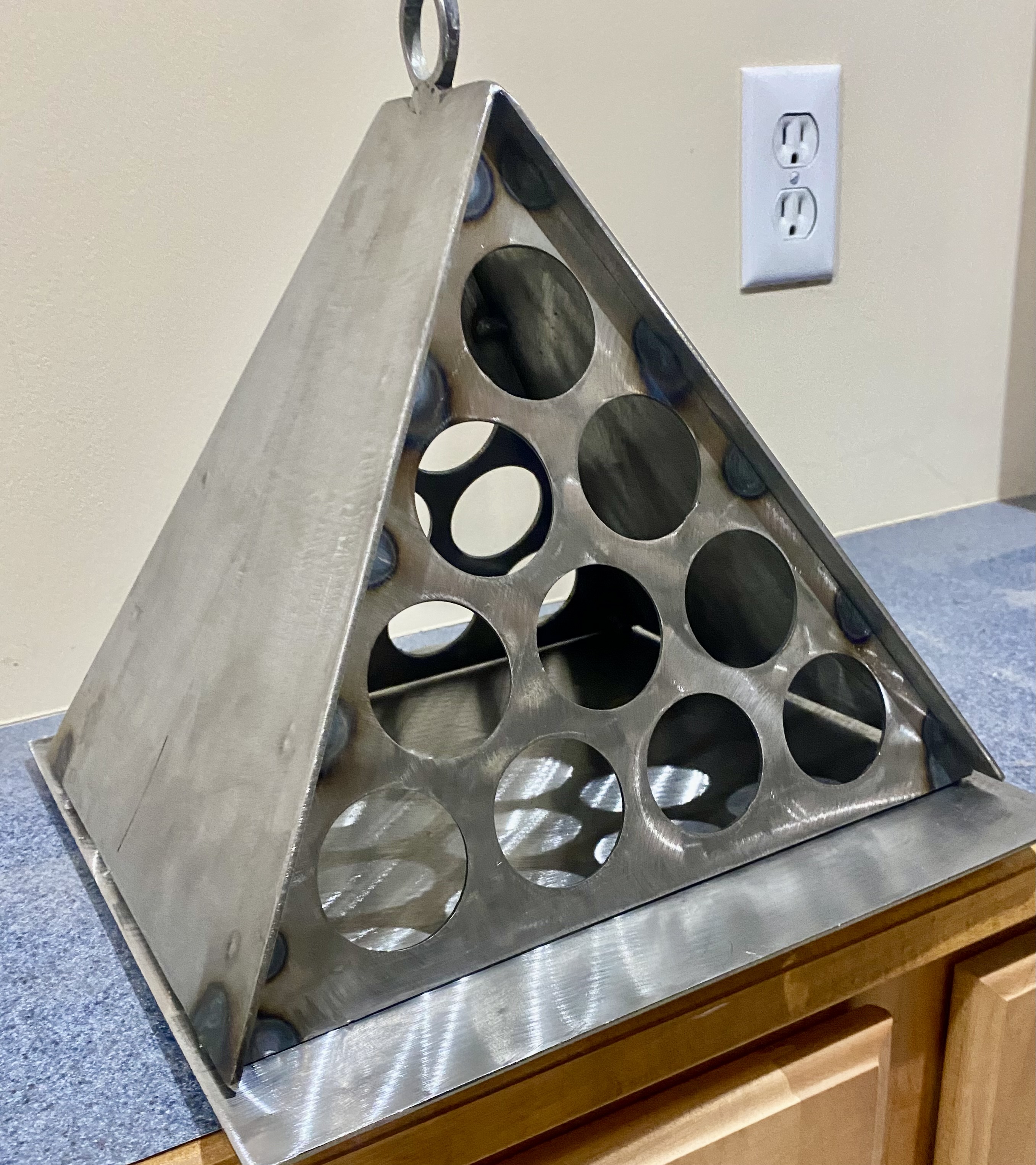

I completed my first project! A squirrel-proof bird feeder. Not quite done but very close.

The squirrels accept the challenge!:rofl::stuck_out_tongue_winking_eye:
I found a video where a guy tested the size hole such that a bird can fit but a squirrel can not. He put a lot of time into his testing. 1.875 inches is the size. He cut 1/2 inch sections of 1.875 id pipe and glued them together with hot glue. I’ll test this soon. Hate squirrels!
