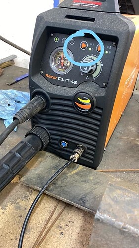

Newbie question, I hope. When my torch moves from one cut to another, it leaves a scar where it cut just slightly instead of turning off. I know I probably have something set wrong, just don’t know what.
You are probably in 4t mode on the plasma. It should be in 2t mode.
Thanks Phillip, unfortunately, I don’t know what that means. It’s a Razor cut 45 that came with my table.
You are in the wrong mode. @mechanic416 showed a picture with the button. In 4t mode it takes 2 cycles of the trigger or relay switch to turn on and off the plasma . Switch modes and try that it should do the trick.
