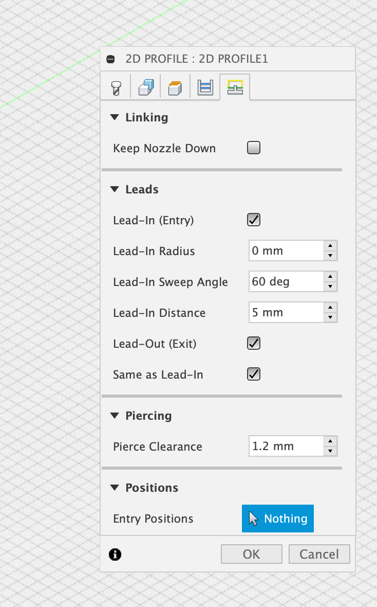

How do I save default parameters in the 2D profile panes (like this one), it would save a lot of time if I didn’t have to change from the defaults every time. Is this possible?
You can’t change them all… Dont remember which ones… You’ll have to try them one by one… But if you Right Click on the setting, and it’s one you can change, you will see the option appear to “save as default” or something along those lines… Give this a try and get back to us…!! GL
Thanks, I’ve changed a few of them but the majority require altering every time. I suppose templates are the solution to repeating these alterations every cut?
