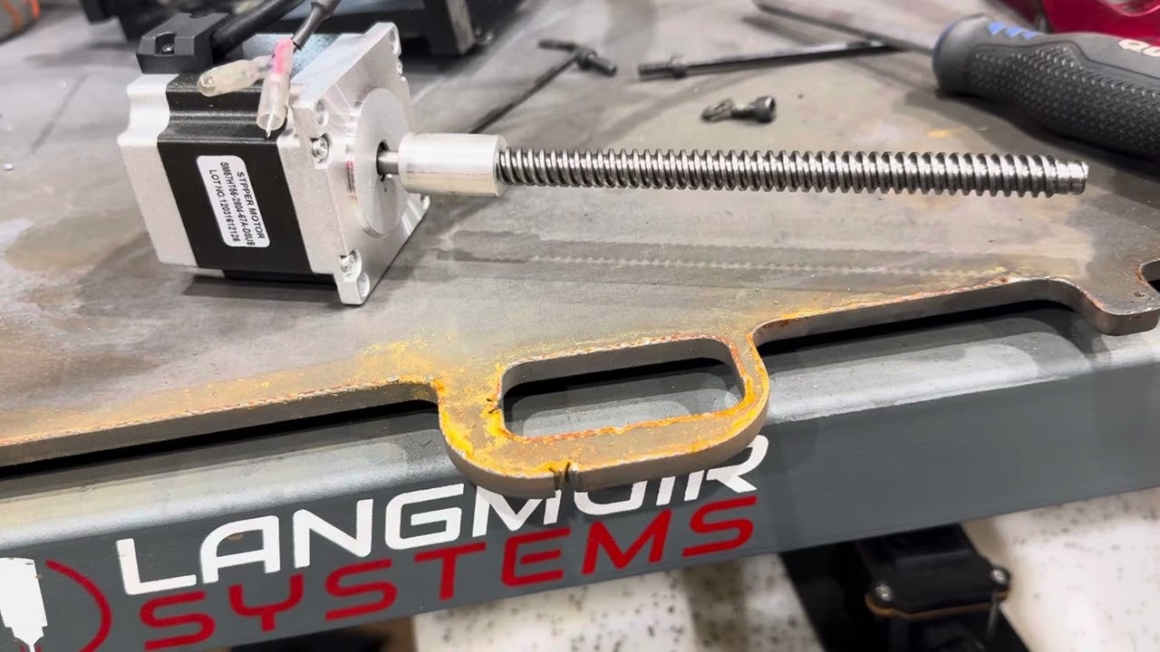

Z Axis Stepper Malfunction: 26 Days after powering on the table.
Z Axis failed mid-cutting a large 1/4" part. Z axis would not move up or down, just hum. Then it would move one way a bit, hum. Then do the same, going the other way like it was jammed up. Removed THC/Z axis assembly, tore it down, looking for debris in the lead screw, failed bearing, etc. I stripped it down to the Z stepper motor with just the lead shaft, and it still did the move and then hum.
I unplugged the serial plug into the CrossFire MCU and reviewed all the wiring for damage or being pulled on. Everything looks intact. I called Langmuir to order a new Z-axis stepper motor. $35 shipped. It should ship tomorrow, Thursday, with the two-day delivery arriving on Monday. Down again min 5 days. Projects pushed back.
Note: the Z axis did this the first time I turned on the table, but it disappeared. I chalked it up to something sitting on the lead screw that cleared. It’s probably related, and the Z stepper just had a gremlin.

Never taken a stepper motor apart, then again half the stuff I try for the first time I am more than not qualified for. Brought it into my office for a clean environment and broke it down separating the end caps and pulling out the rotor. Nothing debris like fell out and no sign of burning or rubbing inside. The field windings with the 4 wires going into them were all intact visually. All the bearings spun freely. Put it all back together with the wave spring washers between the end caps and the bearing seats like it came. Buttoned it back up and took it back out to the table. I first put it into the Z drive to see if there was any sign of life left from it. It came alive and is working as it should! Like 100% no issues.
Put the Z axis back together keeping that darn spring in its cup. (my THC failing cuprite), remounted the torch and its back in action. I will run it for a bit and see if the issue comes back. Meanwhile a new Z motor is inbound incase that is the issue. Always possible its the driver and it resting for 3hrs (all under power) it cooled down/reset it self etc.
