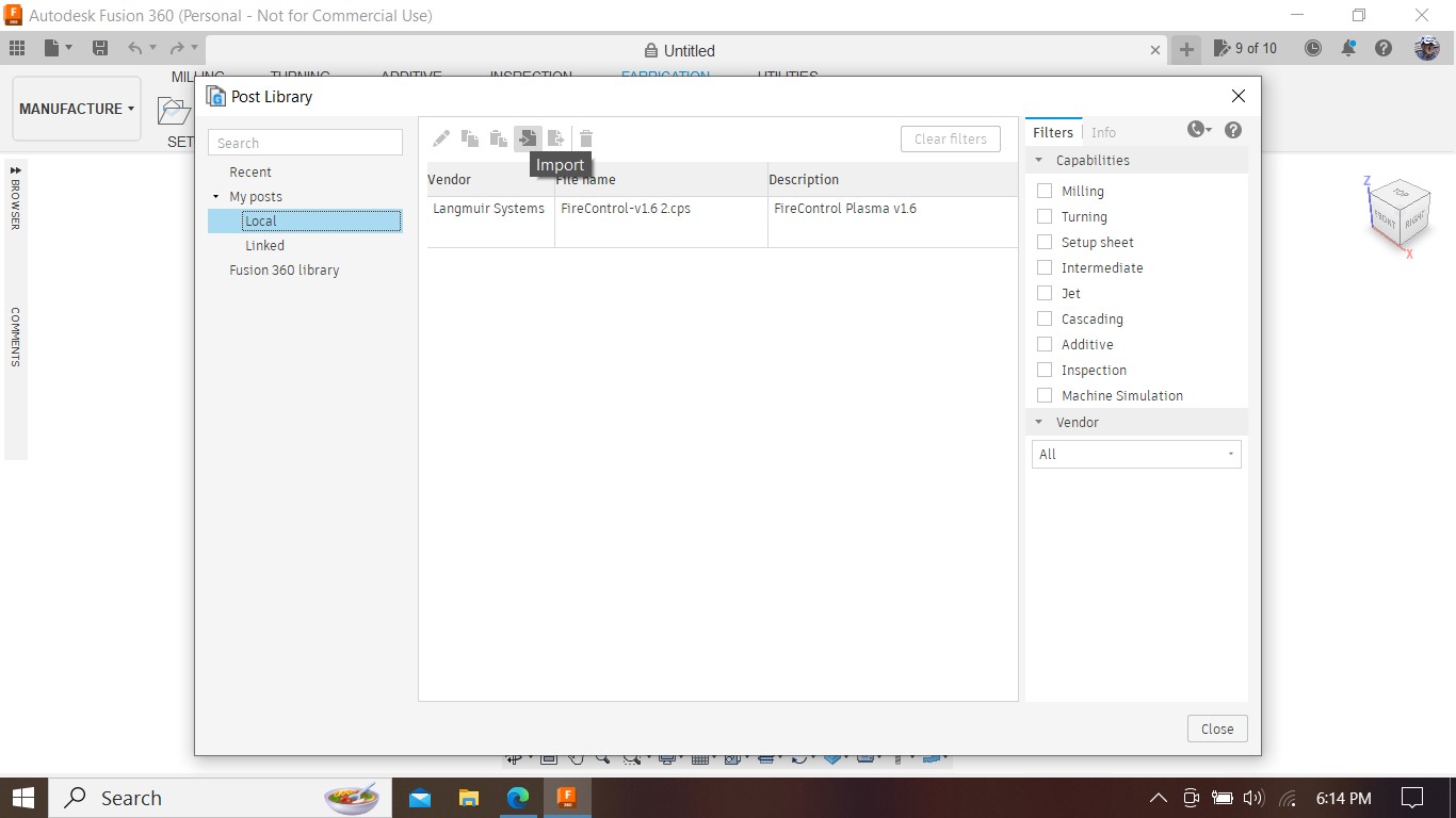

Have you downloaded the correct post processor and shown Fusion 360?
Downloads | Langmuir Systems

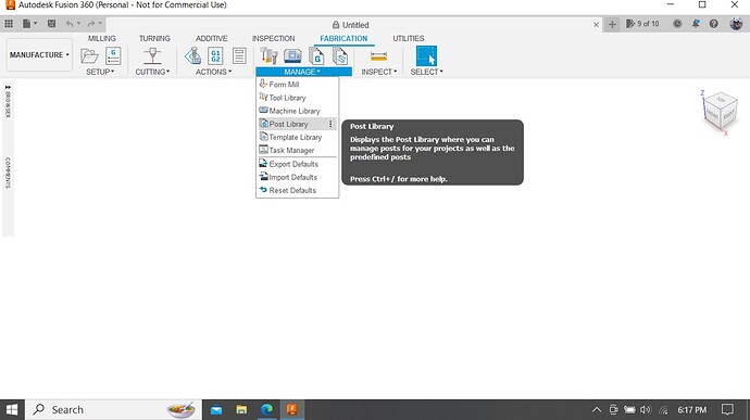

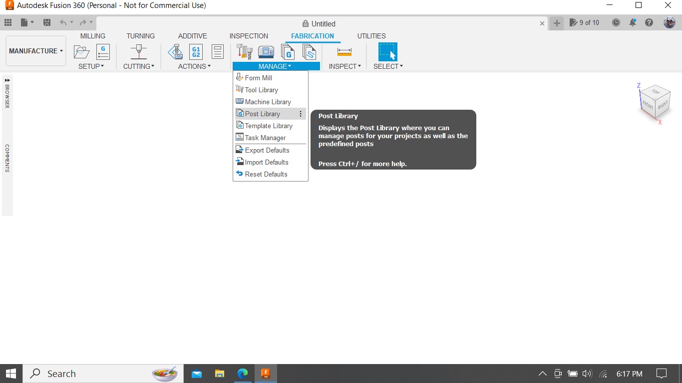

Go to Manufacture, Manage, Post Library, Import.
