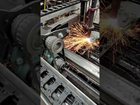

Got to making a cut. Pretty poor quality. I think it’s interesting that even the X has some ripples in it. The straight y cuts are pretty good. The exterior lead in is 12:00 middle of the x straight cut
Two questions:
  1. Are you using a Machine Torch and adding extra air pressure to operate it?
    2.What are you using to keep your long slats from flopping around?
Machine torch and using the internal regulator on the hypertherm 45xp. Slats are 48" long with a curve to keep them solid. The whole table rocks some but I never really had issues with that before. There is a little bit of runout in the 3d printed part that holds the pulley onto the bearing, but I don’t think that would cause much issue.
I wonder if there is an issue with a “lag” with the belt as it changes directions? But that wouldn’t explain the poor cut on the x only sides.
After looking at the video I took of it cutting, I think the mounting system isn’t rigid enough. I can see a little wobble. It’s bent/gusseted 3/16 but apparently that isn’t enough.
