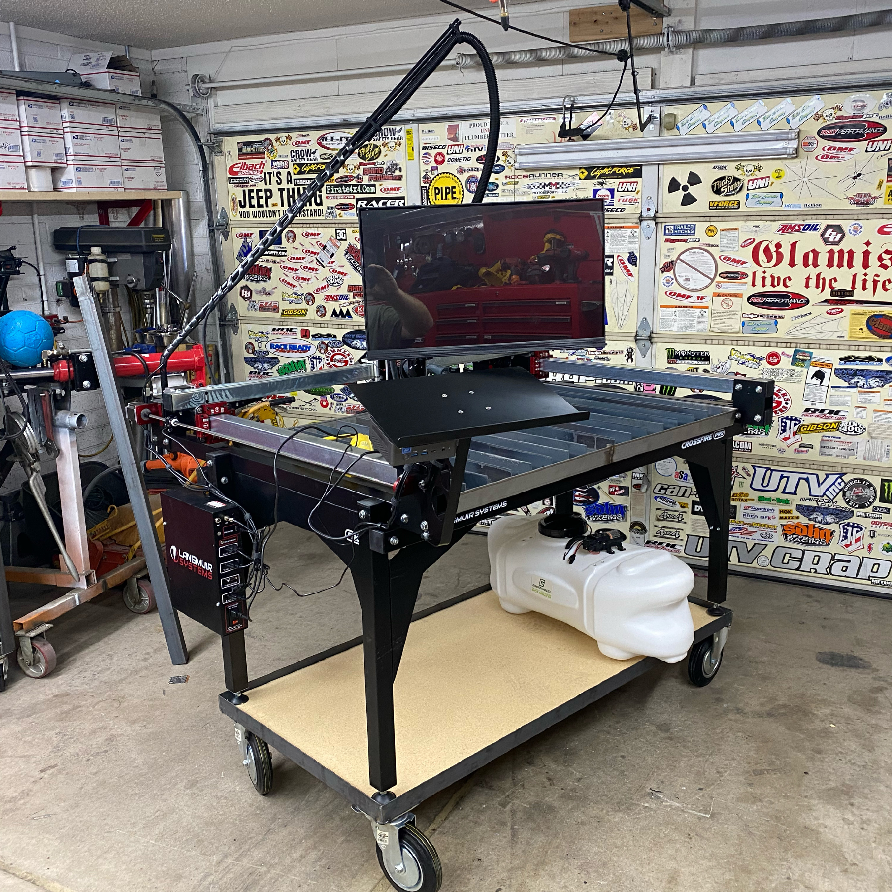

Here is mine, I will use the leveling feet that come with the frame. Just waiting for box one🕜
here is mine
Interesting… your water tank looks very reminiscent of the base to my basketball backboard… hehehe…
Works great hahaha…
I’m just finishing up mine and getting ready to cut.
I built my frame so that the feet slide into sleeves and also made a couple of shelfs, this way I can adjust it by just replacing the spacers inside the sleeves. I thought about pinning the sleeves so that it would make adjusting it easier, however after putting it all together I’m happy with the height for now.

Good Day ,can you tell me what size square tubing you utilized for your base ? Yours is similiar design to what i had in mind . I would like to order it and have it on hand for when my pro showes up .thank you
kingspeedy1 the tube size is 3/16" wall x 2"x2".
I used receiver hitch tubing 2.5" which gave me a little more spacing in the sleeve.
