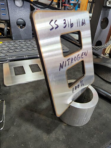

This is a SS 316 switch plate. 11 ga front and back with 100% nitrogen.
More to follow asap.

Here is F5 gas on SS 316 . Edge quality is much better. It does get hotter. I had to turn off Smart voltage due to the fact that the slag on the back was welding itself back together. I set the torch height to .06 in manual. Just a note if you try this the F5 bottle uses a hydrogen/methane regulator. A single bottle with the pressure set at 75PSI was perfect. Plasma cutter air gauge stayed at 75 the whole time.
100% nitrogen gave similar results to dry air. There is a slight bevel that could be removed by adjusting torch height.

I was looking at the pics and don’t see a big difference on SS. I do get easily confused :rofl:
How much better is F5 than nitrogen. Have a side by side pic of the two?
Look at the last pic in post #6,
https://forum.langmuirsystems.com/uploads/db6772/original/3X/6/0/6065ffc776cdfd4fb699780318515fa48a0cb1c6.jpeg
it is side by side comparison of the edge.
Oh I thought that was F5 to air.
Oops, my bad. I missed your request F5 vs Nitrogen. Sorry.
Nitrogen had no positive effect on the SS. Did help on the aluminum slightly, but is not worth the expense.
Don’t have a ss comparison due to they were not any different.
