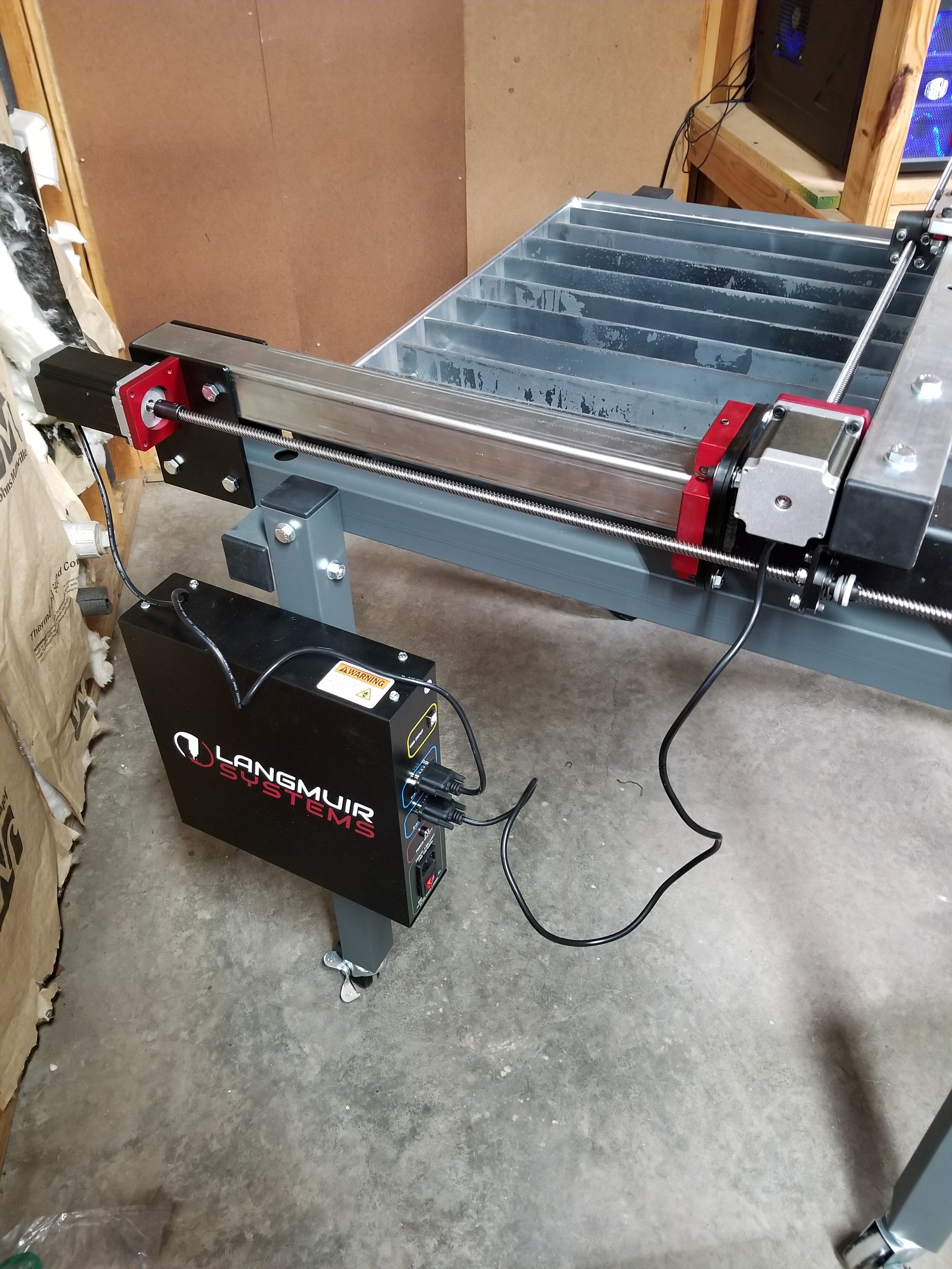

Basically, my X axis is reversed. I press right arrow ( +X )… Table goes left ( -X ). does the same with programs. On the break in program, the origin is the bottom left corner. When i try and run the program, it crashes the X axis until Y gets to +23 and then the x axis will move down and to the bottom right corner on break in program. Basically like X is flipped or something. I checked wires… is there a setting to reverse X axis in mach 3?

There is either an error in the internal wiring of the motor, or an error in the motor driver wiring. Thankfully it’s an easy fix!
The picture attached shows the inside of the electronics enclosure. I have circled in red the wires that connect from the X axis stepper motor to the X axis driver. To fix the issue, disconnect the red wire and the green wire from the plug (you will need to a small flat head screwdriver to loosen the set screws so that the wires can be pulled out of the plug). Reconnect the wires in the opposite orientation. In other words, the green wire should go where the red wire used to be.
After you do that, reinstall the cover and turn the power back on. Your X axis should now jog correctly.

ITS FIXED!!!
The swapping of the wires fixed the issue. Program and keys are working perfect! Appreciate the assistance Daniel!

Could you please post this same info for the Y-axis motor? Mine is jogging backwards.
Should be the same deal. The Red and Green wires in the other connector visible.
