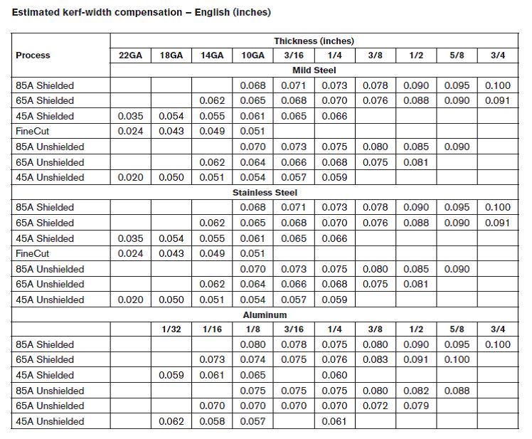

Mind if I ask what you will be cutting to want the fine cut? That’s just curiosity
really just anything, my concern is we take custom orders, so smaller items with more detail all together i need to be able to do. i know im limited by kerf width to a certain extent.
Each plasma cutter is different I understand. Here is a chart that is for hypertherm showes estimated kerf.
Fine consumables can and will make a difference for me I have yet to see the need.
The sync consumables for hypertherm advertised promising difference. I don’t think they actually do much better than standard fine cuts.
There is a big difference between your machine it may give you a idea though.
Jim Colt shared this chart on another forum.
That was many moons ago. :smile:
March of 2019 to be exact .
That is if you are referring to the kerf chart
