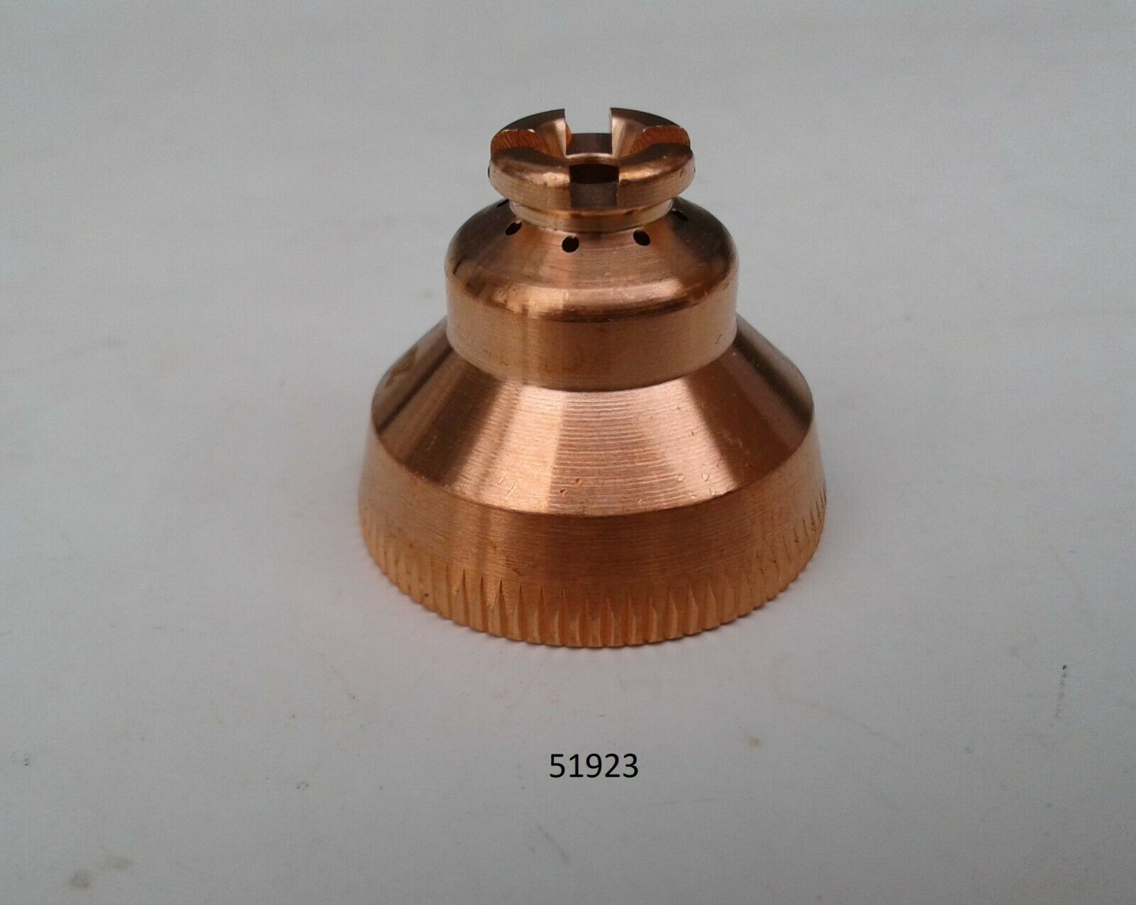

Are you using a hand torch or machine torch. If your using a hand torch you most likely have the drag shield on it. That will never work on the table anyway.
Drag shield
CNC shield

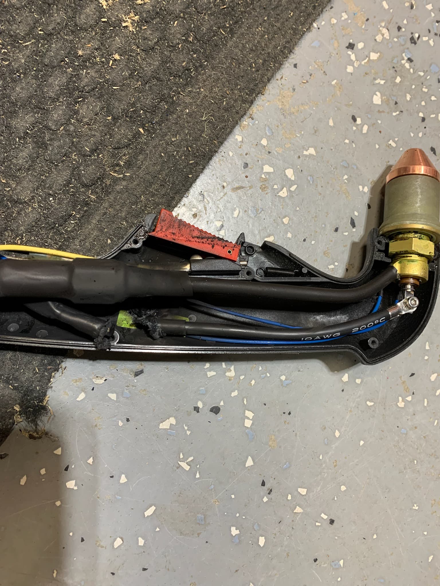

I read on another thread that someone with your hand torch found that there was excessive resistance in the wiring/contacts of the torch trigger. He cleaned and worked on it until the resistance was down to 1 ohm. Perhaps something there to look at.
Thanks for idea to “clean” the torch. Wasn’t expecting to find this catastrophic failure. Since electrical trouble shooting isn’t my forte, given this damage, any suggestions on what else might have gotten damaged before I purchase a new torch and air regulator for the RW cut 45? Thanks to all that responded to my posting.
That looks like the screw was driven right through the wire during assembly of the torch. Was that screw damaged?
Within specification.
@Kwikfab
That didn’t just happen. That has been going on for some time. The positive pilot arc wire was shorting out to the negative power wire. When you forgot to hook up the work clamp it finished it off.
Hard to tell if the screw is burned because they are all black and burn residue on other parts wipe off easily so when backing out screw it may have been wiped clean. Excellent theory given that the damage is directly adjacent to one of the screws. Can I assume the rest of the unit is OK and can proceed with replacing the torch (going to get a machine torch this time) and a new filter regulator (initial try at removing hoses unsuccessful because fittings likely have no Teflon tape or similar and they very tightly seated) don’t want to put in anymore effort if I will end up having to buy a whole new plasma cutter.
