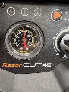

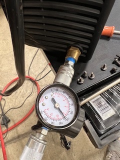

What is the air pressure to the plasma cutter from the compressor? What is the air pressure on the gauge on the plasma cutter? What is the air pressure when the air is coming out of the torch?
Air pressure at the air compressor is 100psi and at the plasma itself is 70psi. The air pressure coming out of the torch head itself I’m not sure I have never measured it. The air is very strong coming out of it though.
There is a gauge on the plasma cutter what does it say with air coming out of the torch? You need at least 100psi coming to the plasma cutter.
You thinking internal regulator went tango uniform?
That would be my guess at this point.
I have 120 PSI going into the machine and 70-75 on the machine itself
The gauge on the Plasma drops to 60 when I try to fire from my computer.

Yes the internal regulator has gone bad. You need to remove it and install this kit ebay number 186715821689 or make your own bypass. You should never drop more then 5 to 7 psi.

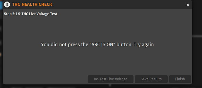

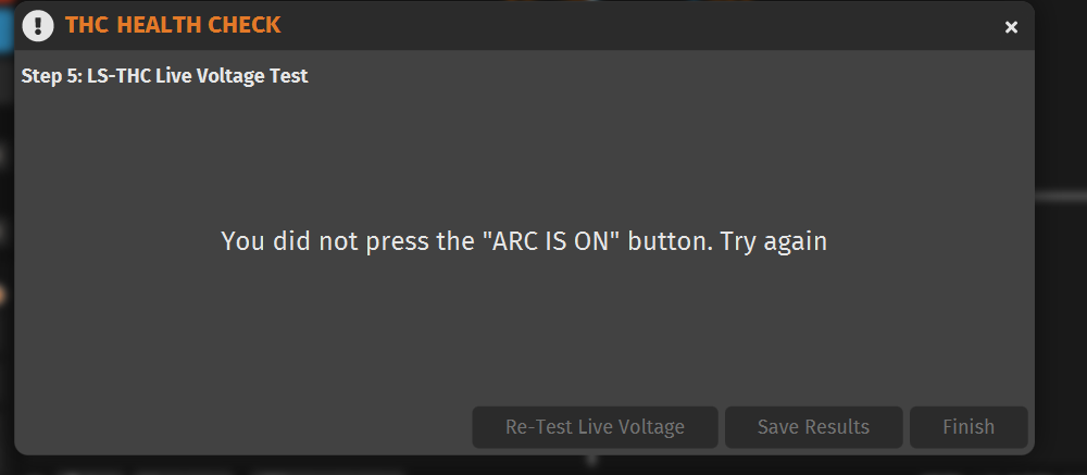

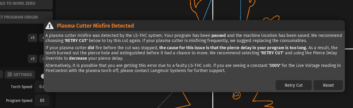

I turned up the pressure to be at 100PSI on the machine and it fired but I went and ran a few cuts, and it is back to no fire. I received an error message see attached. I have tried to fire the torch from the fire button but nothing. I have also tired the THC test, but this will not allow me to hit the ARC on button.
100 psi to the torch is too much. It will actually blow out the plasma stream. 125 to 100 to your new regulator. 75 is optimal to the torch. Is the electrode plunger stuck? I don’t know what torch you have, but the electrode should move up and snap back. That’s how the arc is started. Are you using Amazon or Plasmadyne shit consumables?
