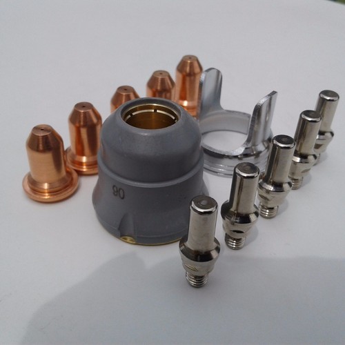

I have had my table for a couple of years but only cut a few things with it, recently got it back out to tackle a project and I am having some angle to the kerf, cutting 3/16 mild steel. I know a little is expected but I seem to have an excessive amount, enough that fitting my parts together requires some grinding.
The consumables are not very old, I just re-leveled the arm and table. I am running it on 90 psi, max amp, 30in/min. I don’t have a dryer just the inline on the razorweld. Any tips to try to straighten the cuts, or is the results I have with the machine to be expected? Thanks in advance.

@brownfox So I ended up buying the tips .8 tips from @mechanic416 and they did not help, still a bad bevel, I ended up grabbing the .9 tips from harbor freight to to give them a shot and they cut the 3/16 nice and straight, so I was happy about that since they are cheaper and local to pick up. My main issue now is that it seems like only get about 15-20 minutes out of a new tip before it starts to blow out a bit and give beveled cuts again, with .8 and .9 running 25-30 amps on the razorweld 30. Does this seem like a very short lifespan? I do have two small inline filters.

I am a little confused here. You say you have the Razorweld 30 cutting 3/16" running at 90psi, 30 amps and 30ipm. 3/16" should be run at 40 amps, 60psi and 60ipm. So your on the border line of what the plasma cutter should be cutting. Also 90psi is way over what it should be. I also assume you are using the hand torch and clamping it by the retaining cup (not a good way to mount it) so how are you getting it square to the work piece? The cut in the picture looks good so it was cutting fine.
Now the Razorweld 30 uses S45 style consumables. Harbor Freight does not sell S45 consumables so your trying to use IPT consumables that are not made for the Razorweld 30 and are over rated for the plasma cutter.
So all the mixing of consumables will not help the bevel. You need to get all the same matching consumables, electrode, swirl ring, cutting tip and retaining cup. Then mount the torch properly so you can square it to the work piece. Make sure you have clean, dry air. The rest is just getting the setting right.

To much air pressure, moisture in the air and wrong consumables. Why are you using Tecmo style consumables on a Trafimet S45 style torch?
Here are the consumables I purchased.
The best I could determine I my razorweld has the IPT40 torch.

No your plasma cutter has a S45 copy torch. The consumables you bought is for the older Razorweld 45 with the IPT40 torch. Also you need a better system for trapping moisture in the air. Those will only trap water droplets, they do not remove moisture in the air.
Picture of the two torch’s and consumables. Also Note: The swirl rings look the same but they are different.
