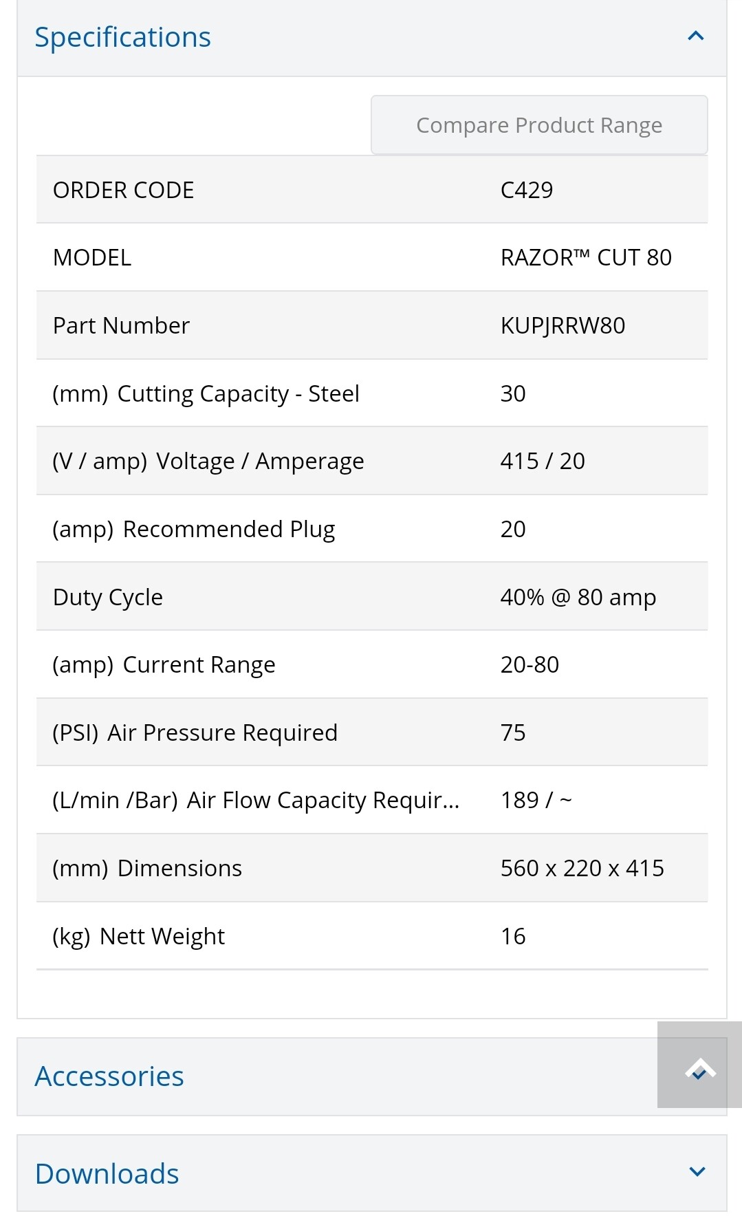

Does anyone have any experience with the razor cut 80i? I’ve searched the forum but did not find much about it. I noticed that razor weld also offers a machine torch for that cutter so it could be a nice setup for the XR table. Thanks for any input.

Does it only comes in 3 phase / 415 volt?
I guess it does come 230/1

Just remember guys to check the output voltage as well. Amps isn’t all that matters. The hypertherm 65 actually has more power then the razorweld 80 because the output voltage is higher. It’s all about total wattage output. Output amps x output volts = total output power.
