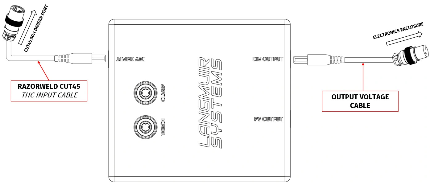

Just bought a used crossfire ,it came with the cut 45 , there are 2 plugs in the lower right corner ,1 four pin,1 two pin , the 4 pin goes to the fire port ,what’s the 2 pin for ,I didn’t get a cable for that one , thx
Welcome to the forum.
Here are some excerpts from the THC set up guide on the main site
Older versions of the Razorweld 45 CNC have a 4-pin Torch firing port and a 2-pin voltage divider port.”
“For connecting the Razorweld 45 plasma cutter to the VIM box, connect the barrel jack end of the CUT45 THC INPUT CABLE into the DIV INPUT socket on the side of the VIM box. Next, connect the barrel jack end of the OUTPUT VOLTAGE CABLE to the DIV OUTPUT socket on the opposite side of the VIM box. See the image below for wiring schematic.”
