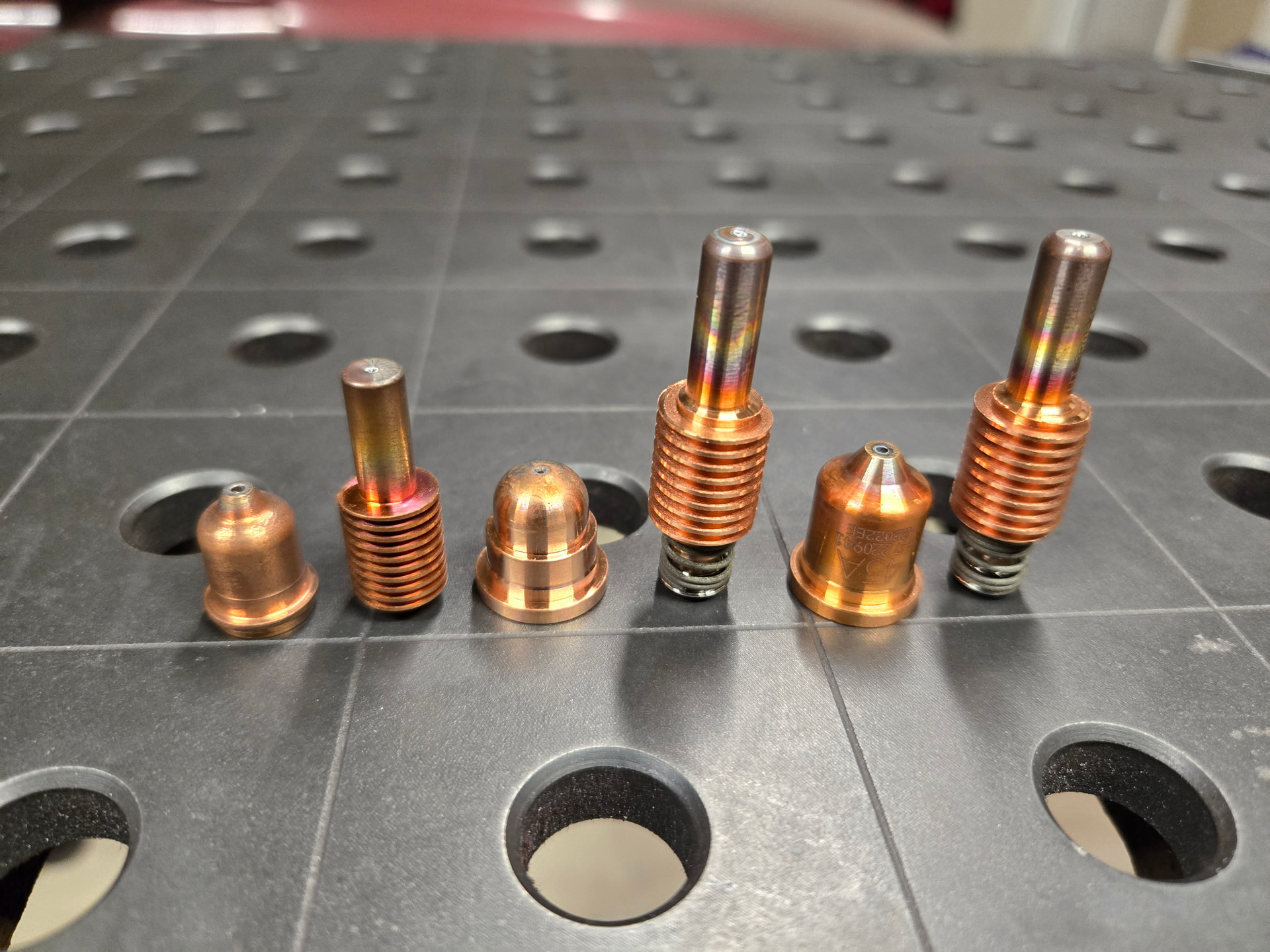

The nozzles the user posted some +3 years ago are that of a Hypertherm Duramax torch.
As far as I know, the machine torch offered by Razorweld with their machine uses the old T45 style consumable.
So no, they will not work as they are physically larger.
T45 (old, discontinued style) on the left with Duramax on the right.
What people did back in the day is use old Powermax 30 consumables (30 amp limited) as they have a smaller kerf, and fit on the T45 style torch.

the machine torch i got with my razor cut last year when i bought my xr table is the t45 style i bought some hypertherm consumables but they did not fit. thats when i realized i had the t45 machine torch
