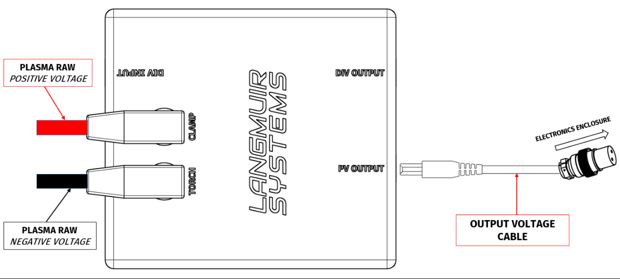

Having an issue with voltage in fire control. I recently switched from divided voltage to raw voltage. I thought I might have the black and red wire crossed from clamp to torch. I made 2 test cuts and observed 4.4v both times in fire control with the wires switched both times.
For some reason, I thought if it wasn’t wired right I wouldn’t get any voltage or a negative.
Black (-) lead should go to the torch and red (+) goes to the “work” clamp.

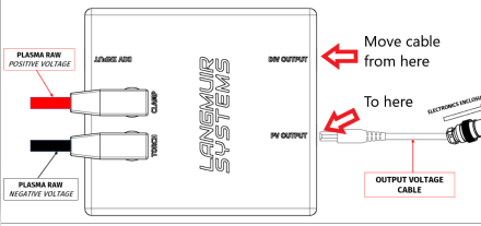

Do you switch ports on the cable going from the vim to control box?
I think you nailed it Phillip:

No I switched black and red wires from plasma to vim box.
Did you switch this cable?
How did you connect your raw voltage?
Did you make these raw voltage connections at CPC port or internally at the main lugs of the machine ?

I went to the lugs.

Could you take and post photos of exactly hoe this is hooked up. pictures of every area wires are plugged in.
The results of your THC are only 4.4 volts ?
to Recap everything is working on your machine besides the newly attached THC?
