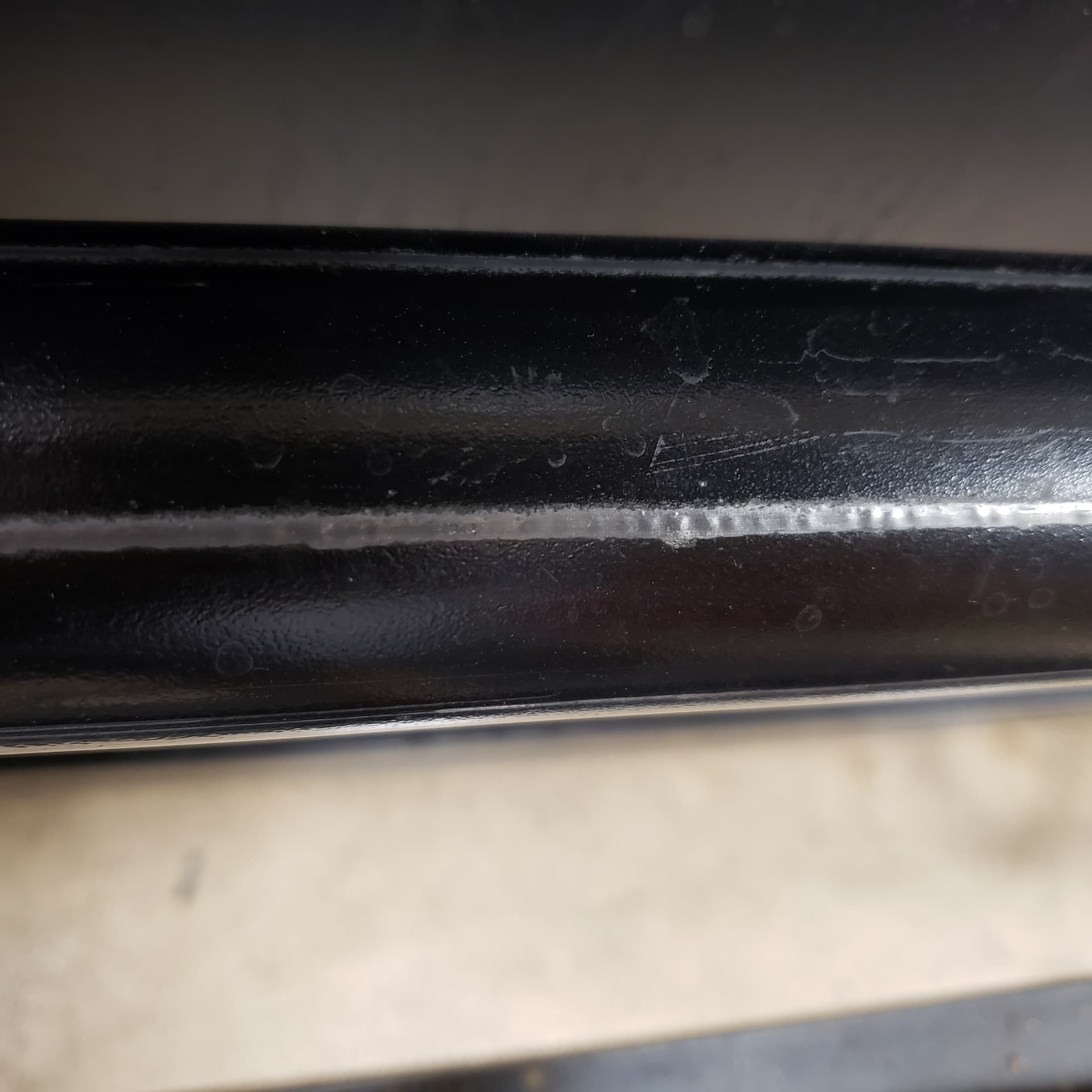

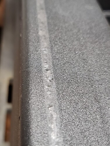

As far as the hardware there is a lot to like and a few things that are maybe a little too “built to a price point”. The table structure that holds up the water table is very sturdy and robust. The water table itself has a very rugged welded tube around the top. We slide 4x8 1/2" (about 650 lbs) plate on this thing no problem. It will handle what they say it will. Driven ball nuts seem to work well and are of good quality from what I can see. My only gripe is the way the bearing surfaces on the gantry (X) and tube rails (Y) are, well, not that precise. The actual bearings are fine but they ride on a powder coated surface that wears through to bare steel (X) and on painted tubes that are definitely not precise (Y).
Not sure that a hardened bearing surface riding on powder coating is optimal. And, in my case, the tube rail bearing just happens to ride on the welded seam of the tube. Again, probably not optimal. However, the XR produces good parts for us. And I guess that’s the point.
If you need the work envelope, are handy enough to build and maintain (not that hard) and need something short of a real commercial duty table (or are prepared to replace things that wear out faster than they would on a $40K table) then I’d say go for it.
