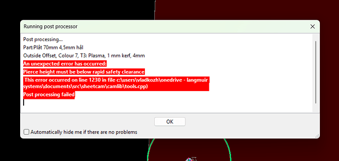

Im trying to cut a circel in 4mm mild steel. My pierce hight is set to 4mm, cut hight to 1,8mm and pierce delay to 0.6sec.
How do i solve this?

Check the pierce height setting in your tool. You may have entered an incorrect value.
You can look in the options menu to find the rapid clearance height. I can’t tell you exactly where, because I’m not near my computer right now.
That error is telling you that the pierce height in your tool is higher than the rapid clearance height in the settings.
Your Clearance value might be zero or slipped a decimal point. In this case NO Pierce Height would be allowed.
Click on “options”, select “job options” and rapid clearance is under material settings.
Thank you! That solved the problem ![]()
