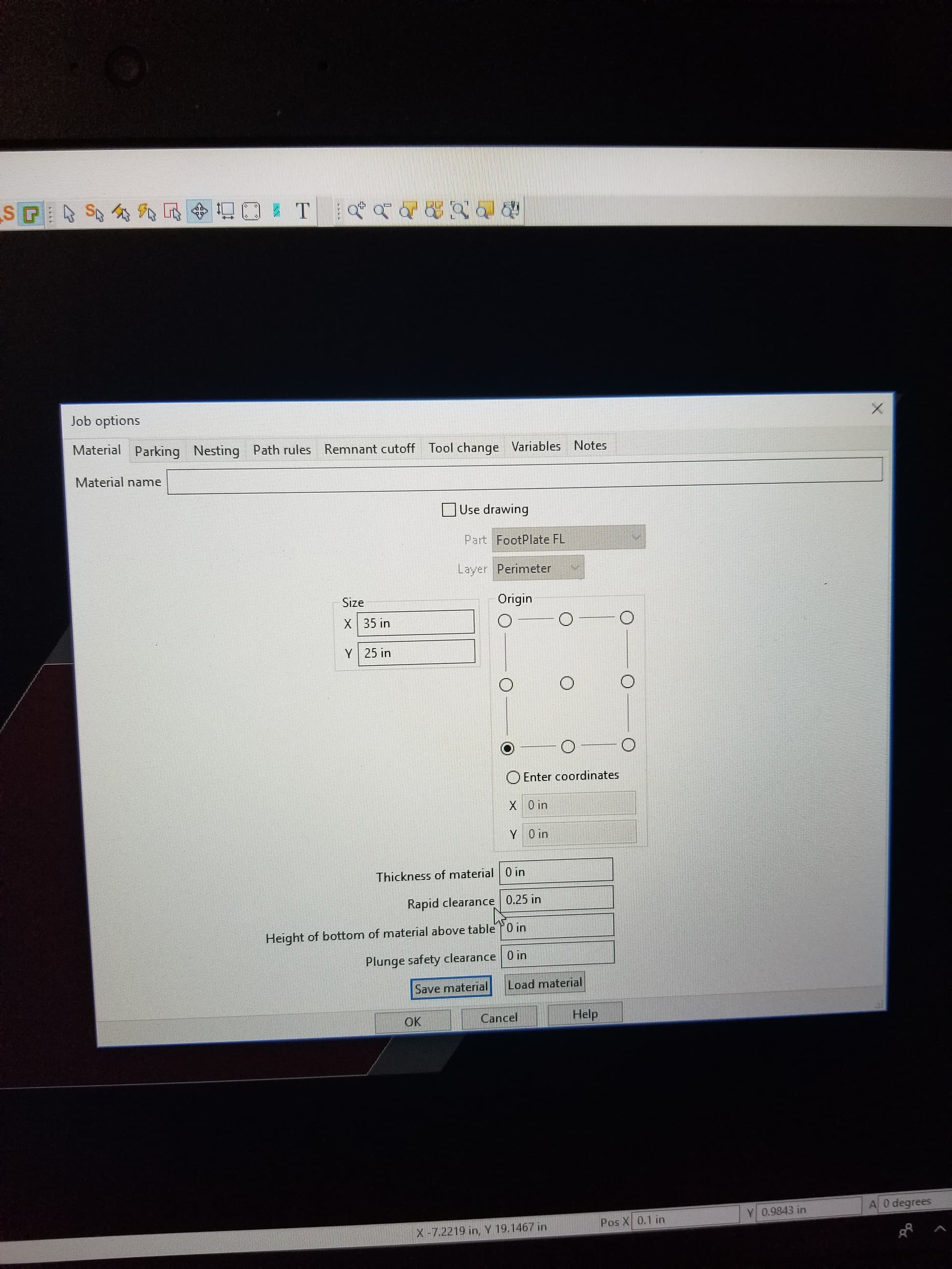

Problem setting parameters for Easyscriber
There are two clearance settings, neither of them are on the panel you show. I think their either on JOB options, of MACHINE options.
Also, you don’t need to send to the code to Firecontrol, you can just look at the G-Code to see what the Z moves are.
I can only find the rapid clearance setting in 1 location in Sheetcam under Job Options. Where is the other?
I did go back and look at the gcode and its retracting 1" between movement even though I set it to .25".
Could it be something in the post processor that overrides what I set in sheetcam?
Plunge Safety Clearance, last item in the list, but I see it’s set to 0. Try setting it to 0.25 also. Other than that, I’m not sure. I’ve modified my PostProcessor, but you could examine the one you’re using to see where Z is getting set in the code…
