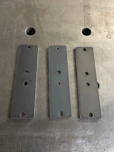

Problem cutting small holes .210
Ok so I have been cutting these brackets for a long time and sometimes have trouble, normally wore consumables.
machine: Razor weld 45
45 amps 110IPM .06 CH .3 PD 75PSI on gauge
I recently switched to a H/T torch a few weeks ago. When I first switched I had problems as this torch required a much shorter PD than the RW torch did. I found .3 was good for 14 ga
So I have a 168 of these brackets to cut and installed new consumables, verified correct cut height and regenerated my desiccant. work clamp on piece. On the holes it will pierce and cut good or it will pierce and the torch will shut off, but it still moves likes its cutting the hole. Some times it might just pierce the hole and stop and throw a error. I dont see any pattern to when it happens, and once going it cuts fine.
Any ideas as to what I am missing? I am thinking of setting PD down to .2

I also seem to be having trouble in that it will pierce fine, then right when it starts cutting it does not cut all the way through for maybe .2" then will cut the rest of the (perimeter)fine.

When I had the PD at .5 it would pierce fine but as soon as it was done piercing torch would go out.
Once I cut it back to .3 if was fine.

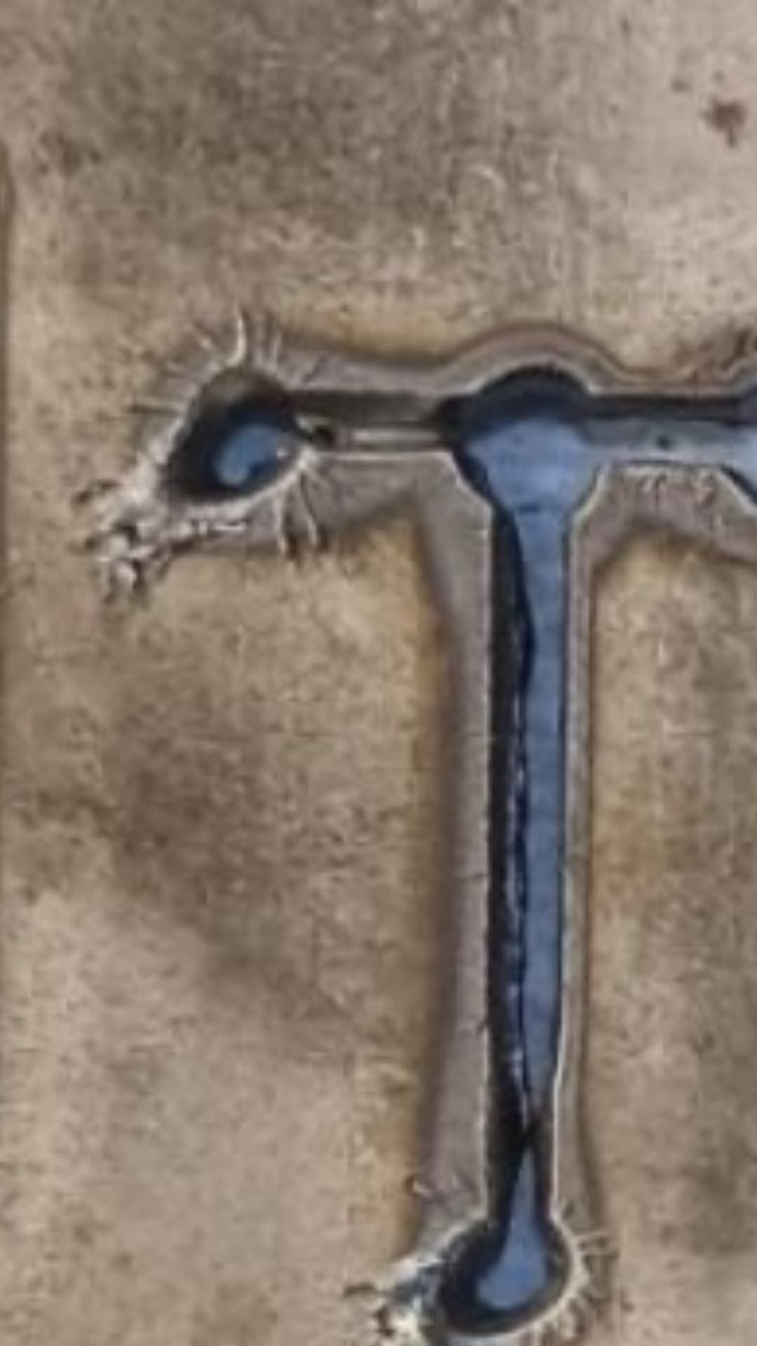

Here is a picture of his cuts. He bumped up to .7 and it fixed him… you say you are losing arc. Sounds like it is burning material away to fast. Like your speed is to slow maybe?
