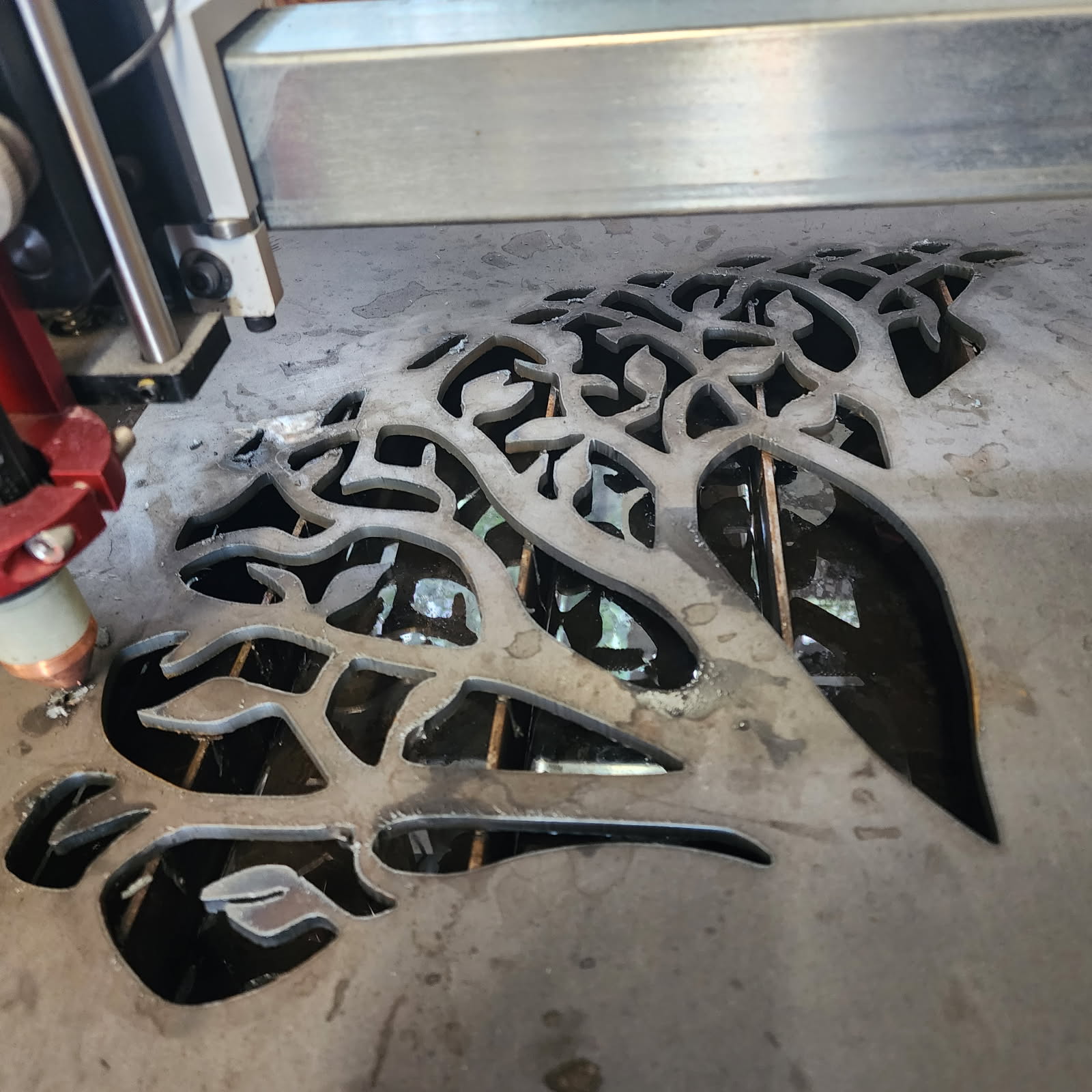

I started my first cut on a piece of 1/8 mild steel. It was going great! But the 2 foot square piece I was using was a few inches short of allowing the cut to be completed. I mainly wanted to see if I had everything dialed in correctly. It was. So, I ran to a steel surplus place for a larger piece of steel. Found something big enough, but it was 3/16. Ehh, what’s another 16th. I placed it on the table and ran the program again. The torch gingerly moved over to it’s start point, just like the 1/8th trial run and dry run. It began to cut a start hole, then it stopped. The air continued until I cleared the following error message. LS -THC Has detected the torch moving before sensing voltage. I rewrote the the program to match the 3/16 change. The data had not changed significantly. I welded the holes shut, smoothed it out, and ran it again. No change. I know it’s something simple I did or didn’t do. Any suggestions? Thanks.

Good news. I rewrote everything. It worked like a charm for 1/3 of the project. Then the same thing. Weird. Looks pretty good so far though. It cut about 30 out of 100. I’ll increase the work gap. Feeler gage shows a 0.05. The final message says to run from the line number loop. I’ll see if I can tomorrow. Error Message 1, Torch moving before cutting voltage sensed. Message 2, Run from loop. Start from cut loop that starts at line 2153. Message 3, Same as the first. Message 4, Run from loop identical. Tomorrow, I’ll weld in that hole and try it again. The ground clamp was connected to the project. Pressure is at 75 psi. I’m going to increase the work gap.
