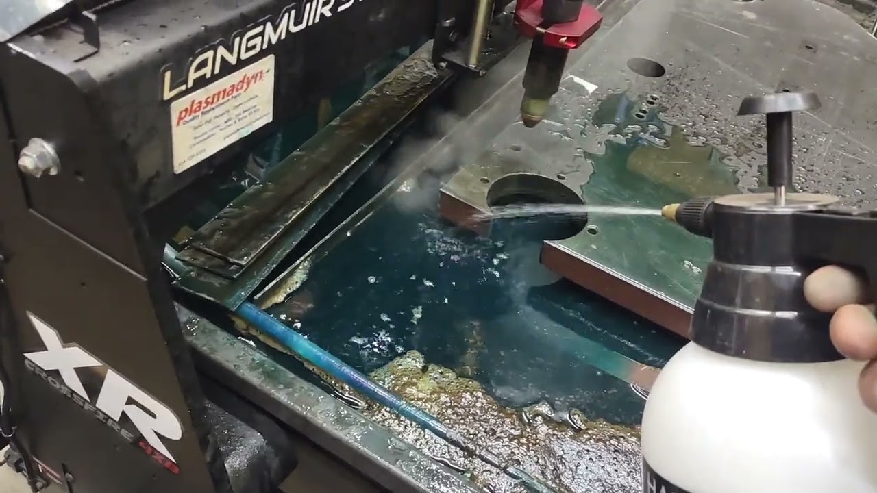

Well, I did an 8" straight cut at 3IPM and 45AMP. It did cut but not sure how well yet.
Tim
Those are crazy nice cuts.
I did also notice that he no longer runs a razorweld45 in his current videos. Upgraded to a hypertherm PowerMax SYNC65
Do you suppose he needs THC in case of warp or air pressure lifting the workpiece?
Don’t think it could be done without duty cycle issues. For sure it would have to be an edge start. Travel speed would be less than 1~4 ipm. Definitely I would put a piece of 1/4 plate under it in the water table to prevent pan damage.
