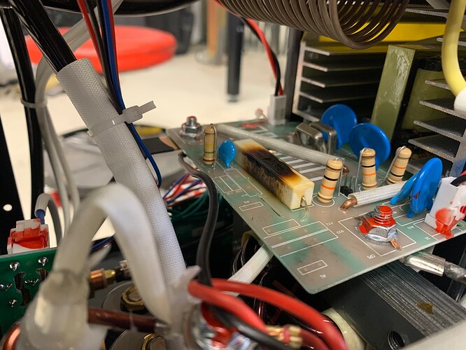

Gentleman, honest answer. Whoever owns a Primeweld Cut60, does it function correctly if you were to tap in for Raw voltage? If someone were to use the cnc port would that be a problem? This plasma cutter is killing our Motion Control Boards and I need feedback. Anything helps.
We always tell people to run raw straight to the lugs.
Raw from the CNC port is still going through some sort of filtering so we advise against it.
Ran a PrimeWeld CUT60 a few years without issue when I ran it raw straight to the lugs.
I was one of the guys who’s VIM burned out while running divided.
I’ve had mine hooked to the cnc port for about 3 years now, only problem I’ve ever had has been the THC after a year of use. Tried the USB isolator LM sent me but that seems to hap-hazardly lose connection to the control so ended up just doing the ground plug removal to fix that issue.

This is a picture of the divided voltage board. This has happened many times. Raw voltage is the way to go. Yes, it works for some but not for others. Why have this problem haunt you down the road.

i’s hard to say what the actually cause of the VIM’s burning up but as Kwikfab stated, we usually just tell people to wire it for RAW voltage from the get go.

I also have a gen 1 Cut 60 . I could not make the divided voltage work. I used the Cnc plug and the raw voltage taps. As of today I have not had any issues to note. I have both a regular and machine torches.
