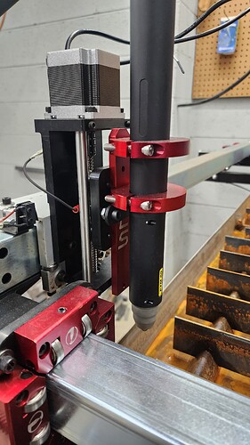

Two different machine torch mounting strategies using the Langmuir mount and staying away from the torch head. Taken from other members of these forums, and I forget now which was posted by whom, but either one should work. After reading through, it sounds like this isn’t your issue, but according to @mechanic416, you might create a new one if you continue to hold the Tecmo by the torch head. :grinning:
Good luck!

Yes, my attachment was incorrect at the start of this puzzle but both Primeweld and George pointed out the correct method. So mine is attached to a fixed (no Z motion) mount like the top photo.

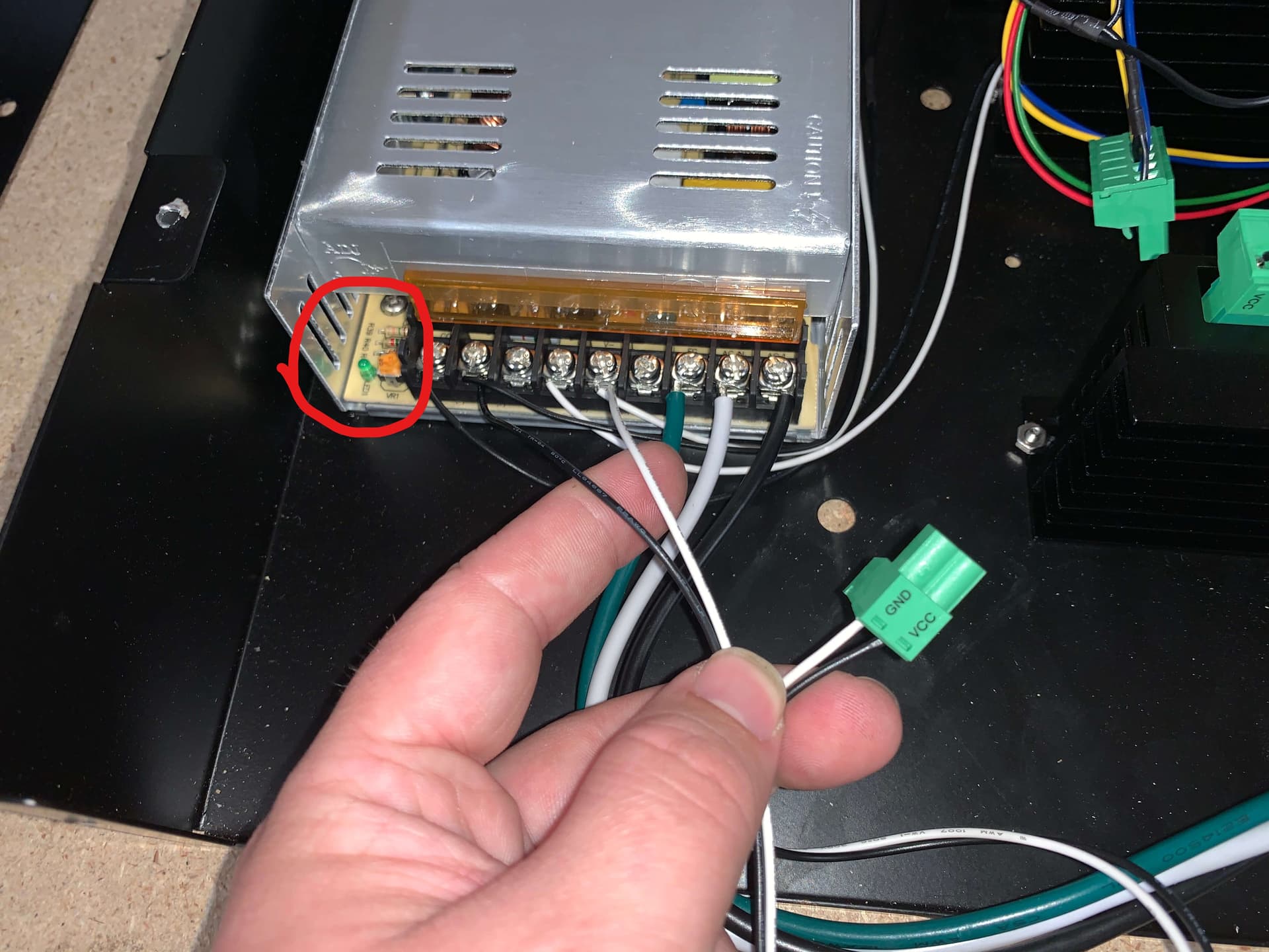

@Thanet58, do you have a meter to test the voltage on the power supply? another user on FB posted something similar to your problems and found out the voltage coming out of the power supply was set too high. once he adjusted a pot on it to correct voltage, he was off and running again. Wouldn’t hurt to check to rule that out.
when you test between a pair of the black(+) and white(-) contacts on the power supply, you should be getting around 36v. the Guy on FB was reading around 45v. he turn the pot down until he was close to 36v and ran a file that was gibing him trouble before and it cut without issues.
Thanks, I didn’t get to try this as I had other results before I felt ready to open the case. Appreciate the pointer though.

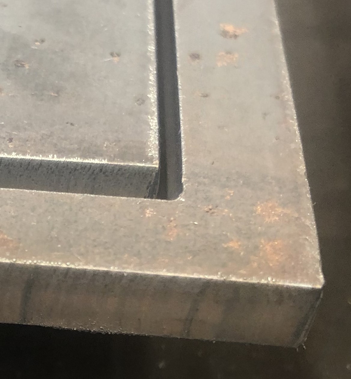

Well I dragged the compressor 100 yds uphill through gravel to place close to the Cut 60. The racket when it is going reminded me why I placed it 100 ft away in its own vibration and noise isolating min-shed… Anyway, absolutely no change whatsoever when the hose length was now closer to 10’ All the regulators seemed to be doing their thing correctly as did the compressor auto-start.
So, I decided that I would accept defeat and just use the 5s pause between cuts. No biggie really as this reliable workaround would add 2 minutes at the most to any job I had planned.
I did one last test to check that long single cuts are fine and they were. This was a single cut twice around the perimeter of a 20" x 20" piece of 1/4" mild steel so it was close to an 18’ continuous cut. The two cuts in the corner are pass 1 and pass 2 are raw without any clean up whatsoever - i’m quite pleased with those and used the parameters straight out of the Primeweld owner guide. 45A, 60psi and 47 IPM. The air didn’t falter once and the compressor only coming on after about 12’ of cut.
