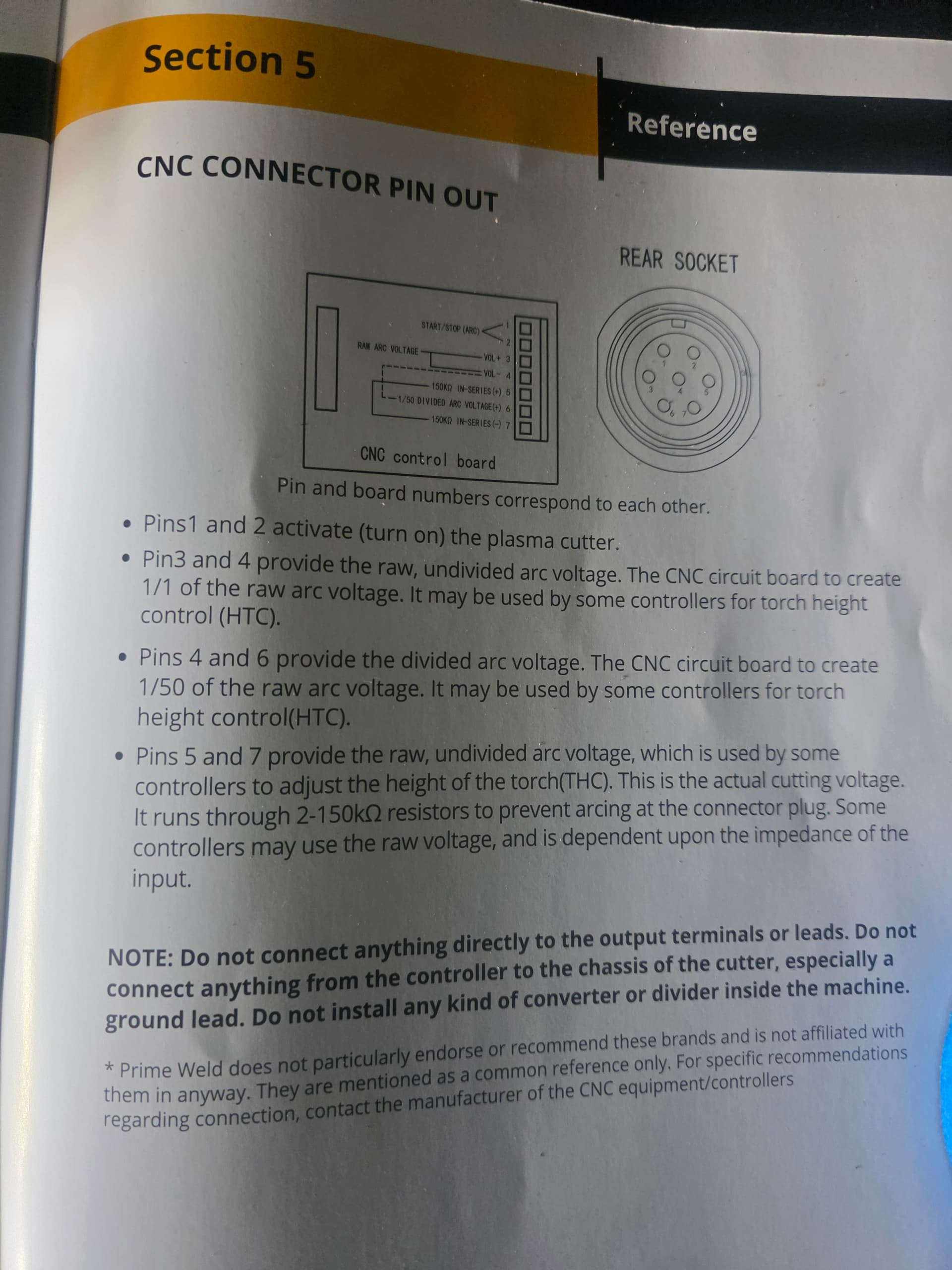

Yes, aware of that manual.
This is for hooking up to Raw voltage. This is my recommendation.
Ok div wires red and black go to cnc wiring port pin 3 and 4 the torch on are pins 1 and 2 where do the torch and clamp go?
I have that model and that is the way it was hooked up but this is the new model cut 60.
Pin 1 and 2 are the torch trigger. It is just a switch so the hook up is either wire to the Langmuir controller box that says Torch on and off. I would hook it to raw voltage but you can use pins 4 and 6 for divided voltage. Pin 6 will be the positive. Pin 4 the negative. This is important to connect it correctly to the VMI box.
Id like to stay with raw voltage. I’ve had good luck with that setup.
Then the download I sent you will work. You will still need to solder pins 1 and 2 to the torch switch. Just remember that the torch is negative (black) and the work clamp is positive (red). This very important
Ok so even on the new version to use raw voltage I’ll still need to hook the clamp and the torch wires inside the plasma cutter like it was before ?
For any plasma cutter without unfiltered raw output, that is correct.
Directly inside the machine.
No, but I would. But you could use pin 3 and 4
Pin 4 is positive and pin 3 is negative. My advice is to wire like the download says. Your call..Adobe Acrobat
the RAW voltage write up won’t work on this newest version of the cut60. everything is done via the cnc port.
divided voltage works fine as it should on the newest cutter. no need to run RAW.
I don’t think i’ve seen users of the newest cut60 running raw voltage yet so i can’t confirm that it works properly.
Just to make sure it would need pins 4 and 6
Yes, for divided voltage, pin 4 is negative, and pin 6 is positive. This is important to get the polarity correct. Good luck. I guess the latest version is fixed. @nicaDd
