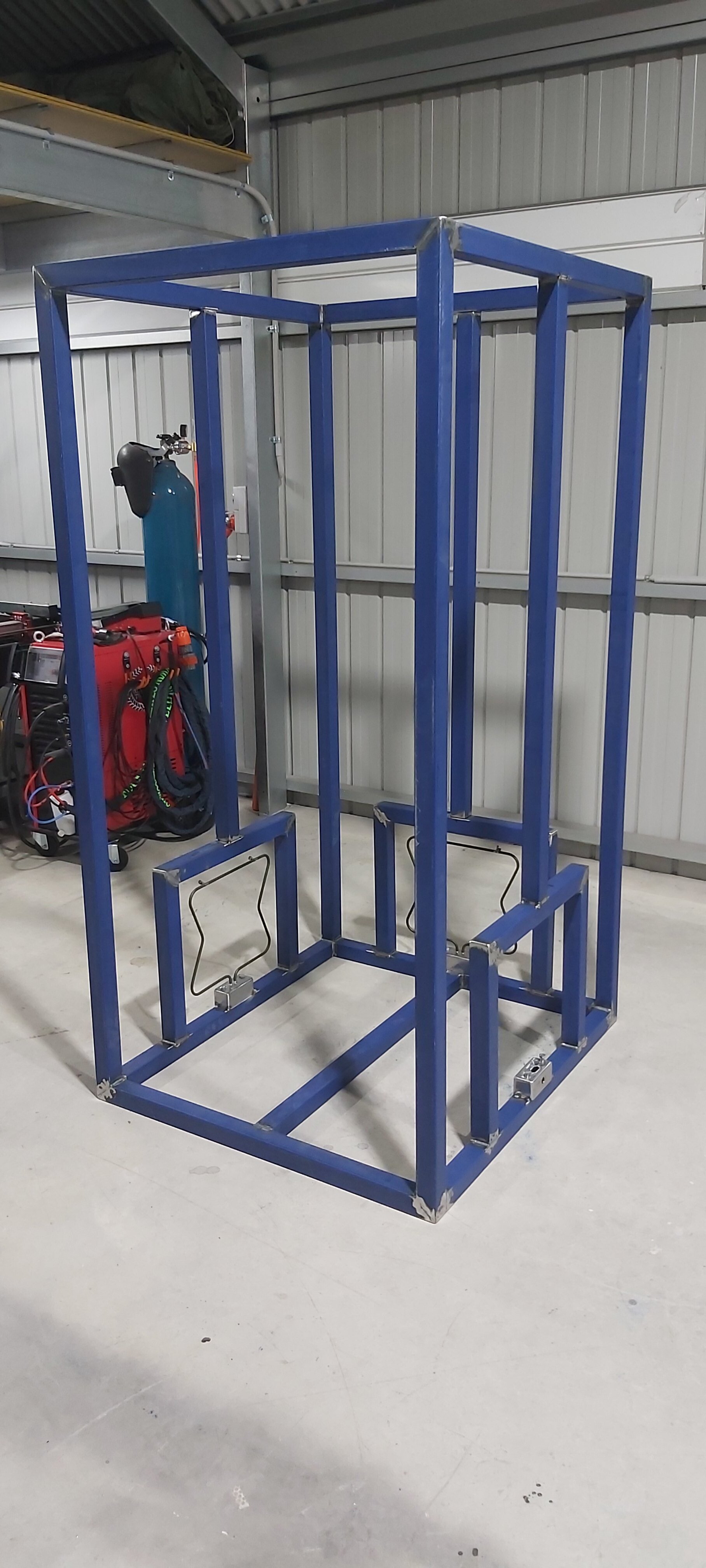

Hey all, thought I would post a few pics of my powder coating set up I made.
Hell ya!!! I am looking into building one similar to that size soon. How much do you have in just building the oven, minus the controller.
Not cheap to be honest. I am based in Australia so material prices would be different but I would say maybe $3000 AUD without controller.

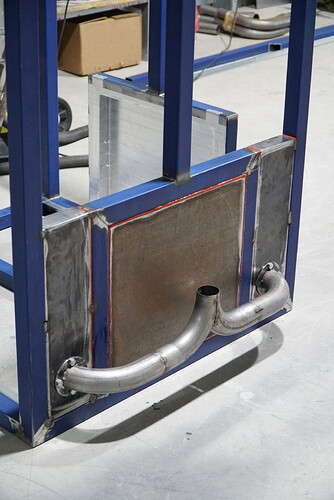

There is over $1000 AUD worth of insulation in the oven.

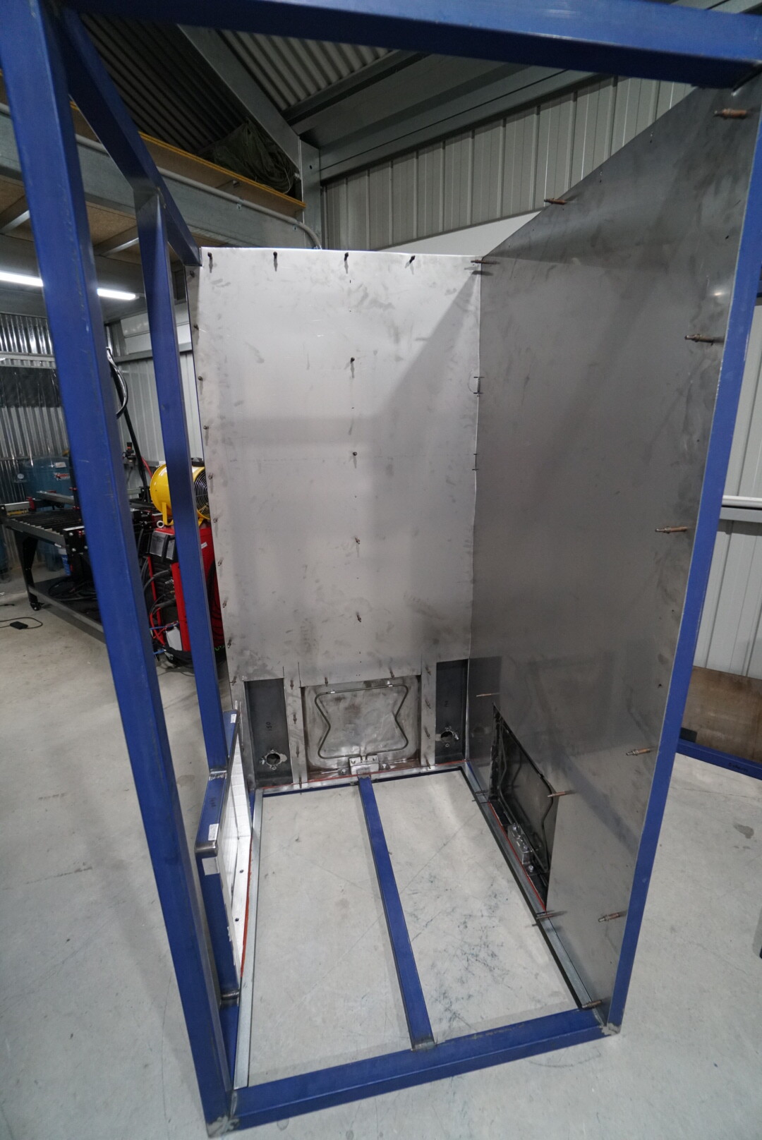

Mine is actually a fully welded frame clad in stainless steel inner, 50mm ceramic fire blanket insulation then ally checker plate outer…
The designed changed as I figured out certain things would not work etc…
The heat soak from 200 degree temps is the biggest challenge.
My biggest advice do not cut corners and do not try and do it on the cheap side !! You will pay for it later down the track.

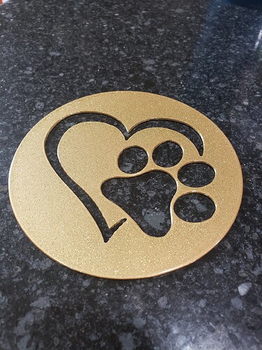

Ive been diving into powder coating. I have a redline ez50 gun, homemade spray booth and old house oven. Planning on building a booth and an oven that will allow to powder coat up to the size my table will cut. For now, about 19x22 inches is the max I can fit in my oven. I’ve been experiments with different colors/combos. This is my favorite so far, its Gold Medallion base with Disco Lemon Drop from Prismatic Powders
