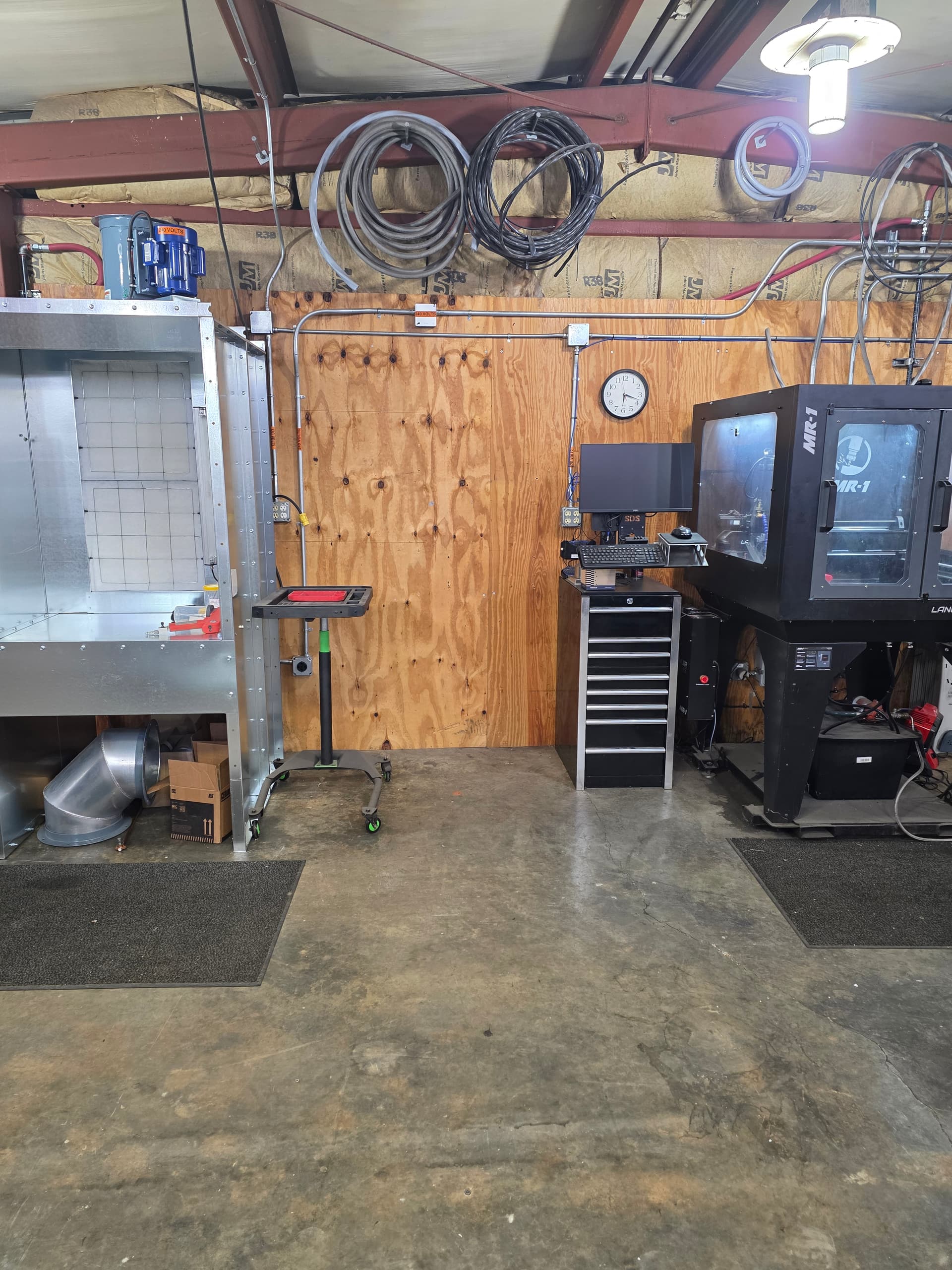

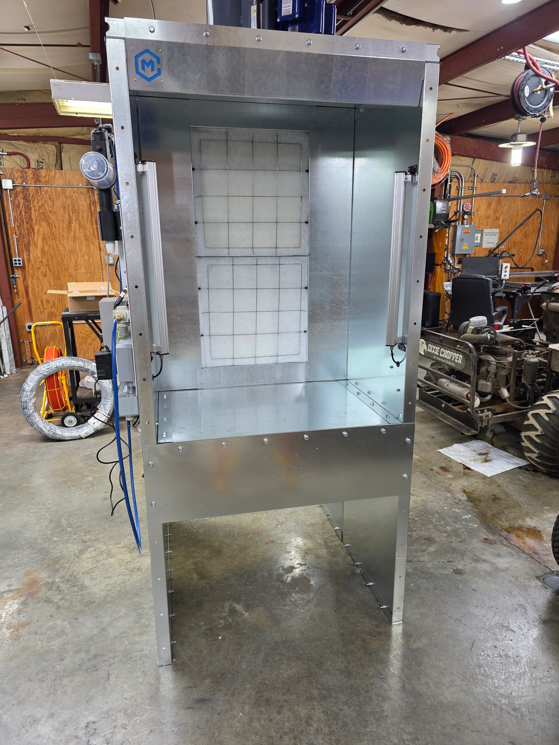

Cook manufacturing 3x5 $2300.

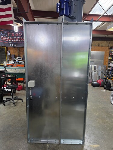

That’s a nice setup, anything you don’t like or suggest about it,
Did you order with lights or add aftermarket.
Did you exhaust outside or go with the Diffuser / Final Filter assembly
The Lights are from Amazon, and the exhaust goes out through the roof. The filters are from Cook Manufacturing. I wired the unit myself with a magnetic motor controller.
It works really well. Almost all the overspray goes out through the exhaust system, and cleaning up with an air chuck is easy.
OK last question before i order a cook mfg unit, dose the 3’ wide by 5’ tall work well or do you wish you went 4’ wide, i know the vulcan is only 30” wide but i figured i could also use booth for any spray paint i do as well. But same time im limited on room till i move operations or build a new garage, either one is a few years out so smaller the better for now!
I don’t, but it is plenty big enough for me. The Vulcan 16 can only fit a 30x28 part.
It comes with a 12” axial fan on top. I would get the motor controller and whatever you need to exhaust it outside. All the lights and wiring were my creation. It works great. I also installed a stand-alone ground rod outside the building and got less than .25 ohms to earth. When you’re ready, I will send pictures and the parts I used.
The axial fan pulls almost every particle out the vent. I have used it 50 times and it still looks brand new. A shot with an air gun and it’s clean.
