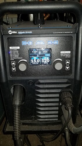

Hello all,
I am now in the market for a TIG welder, having received numerous requests for aluminum and stainless work.
I’m looking for a suitcase-sized unit that can be transported if need be, ideally 110/220 capable.
I’m curious what you guys might have at work, or home shops, and how they perform for you. I’ve looked at the Lincoln Square Wave, and some other welders on Amazon, and it seems there’s a significant price difference between an analog/digital machine. Is there any tangible difference between the two, and would I want to opt for a full digital unit? (ie a regular tig versus “squarewave” capable machines)
If your primary focus is aluminum then you need a “AC/DC” machine. Most of your cheaper tig welders are are not AC/DC and will not weld aluminum other then maybe a beer can.
Aluminum takes alot of heat to weld, you will not get that out of any 110 v machine.
Tig welding is not like mig or stick where you just set it and forget it. You have settings like pulse etc that it takes alot to get used to, the new digital machines take all that out of it and set it for you and are much easier to use hence: the extra money and it is worth every penny.
I bought this machine this spring and it is a beast, great machine. Very pleasurable to weld with.

I have only run 10 ga- 1/8" stuff with it, my son is a professional welder and he has used on 1/4"+ material.
He taught me to tig with this machine, it was fun to learn. Some folks on here have the everlast machines and they like them just fine. A couple of my kids buddies bought the Harbor Freight version of this machine and returned them after trying this one, they are professional welders as well but almost all structural/highrise work. They tig on their hobby stuff, dirt bikes etc.

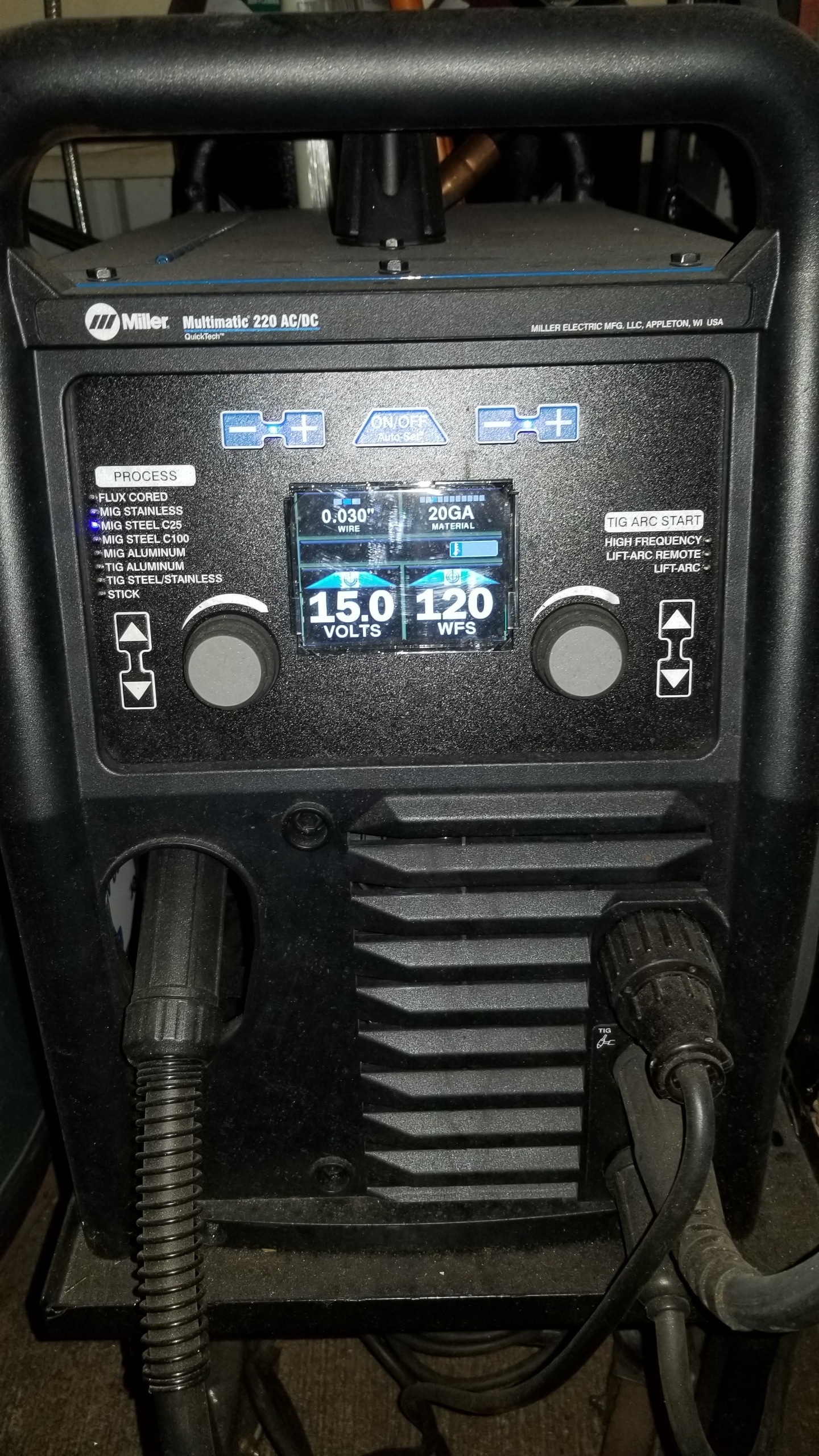

I’ve been drooling about this machine since it came out but I haven’t convinced myself to spend the cash. https://store.cyberweld.com/miller-multimatic-220-welder-907757.html
it’s a do-all machine with AC/DC TIG. It would compliment my existing Miller 211 nicely because I could use my spool gun I currently have.
It really is a nice machine to use, I love it. I sold two welders, a mig and a tombstone stick welder when I bought the 220. it is so nice to have one machine to do it all.
I would still keep my 211 and keep it set to mig weld steel and then use the 220 for MIG & TIG Aluminum
