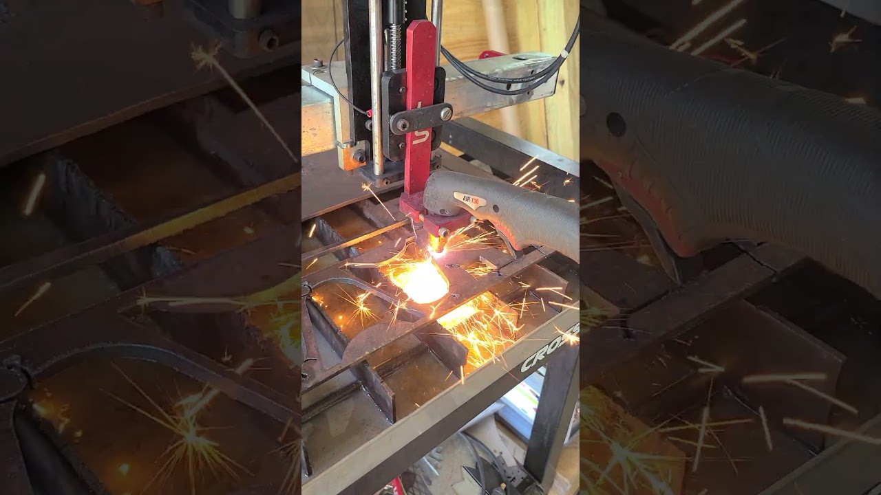

got a powermax 30air. its been cutting great. i went to use it today and its not cutting through the material. But if i remove the torch and use it manually it will cut through the plate. anyone had this issues before?

hypertherm powermax 30air. plasma has built in compressor. 2Ă—2 crossfire table. hp victus laptop. i did the updates in the help menu. still no change. made a test circle in sheetcam along with my original part that didnt cut. cutting at 32ipm which has been working great until now. no changes in settings as they were working fine before.
I’m having trouble understanding what the problem is. Is the torch firing at all when commended by Firecontrol? Have you tried a straight line cut using firecontrol’s built-in tools rather than other software, just to troubleshoot?
If the torch does fire is it piercing through the material before it tries to move or is the pierce not working either? Is there a way for you to video this issue and upload it?
i got a video but its not giving me a video option to post, only pictures…
I usually upload them to my youtube account and then post the link. If you haven’t done that before it’s worth figuring out.
looks to me like the pierce delay (PD) is way too short. When I see all of those sparks it leads me to believe you’re not all the way through the metal. What is the PD set at? Whatever it is I’d add quite a bit.
i changed it to a 2 second pierce delay and 10ipm still barely cut through it. its not that. something else is wrong.
I bet it’s your plunge rate. It sometimes defaults back to the 3 ipm number. Fix that and you’re probably good to go
what should i set it to?
Set it to 60
I was replying quickly this morning, but I’ve seen fields in sheetcam default to 3.XX IPM for some reason when tabbing through fields.
That’s definitely your problem though, that’s why it’s not piercing and will only cut once the torch drops enough to cut all the way through. It’s just not reaching cut height fast enough with the plunge that slow.
ill give that a try and let you know what happens. i appreciate the input.
hey brother, just wanted to thank you again. shes cutting like butter now.
