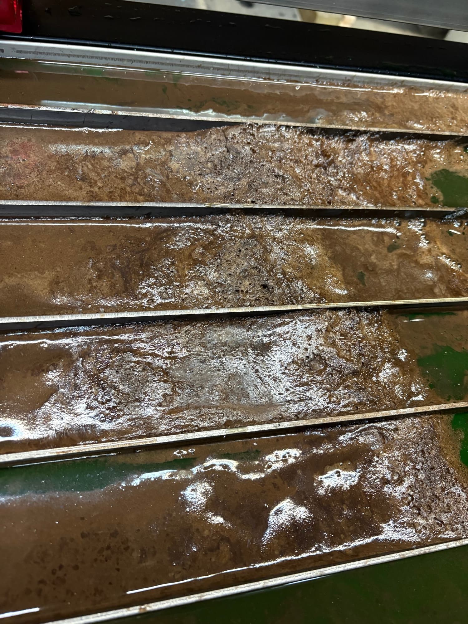

whereas I have no other frame of reference, this is what I’m getting in my table using Plasma Green 9010. When water tray additive is needed again, I’ll be trying a different product.

Imagineer, this is Mark Konzen from KCI Chemical. We make the Plasma Green additive, and thanks for using our product. I looked at your photo, and Plasma Green 9010 should not produce a brown sludge as shown in the photo. There’s nothing in the product that will leave an oily deposit, and certainly at 5% concentration, could not produce that much volume of brown sludge. However, Plasma Green 9010 will act as a mild metal cleaner, and will remove sludge or oil from metal surfaces. My guess is that there was an oily build up in your table that was removed by the Plasma Green. Once the brown sludge is removed, it should be less of an issue going forward. Please feel free to contact me if you have any questions.

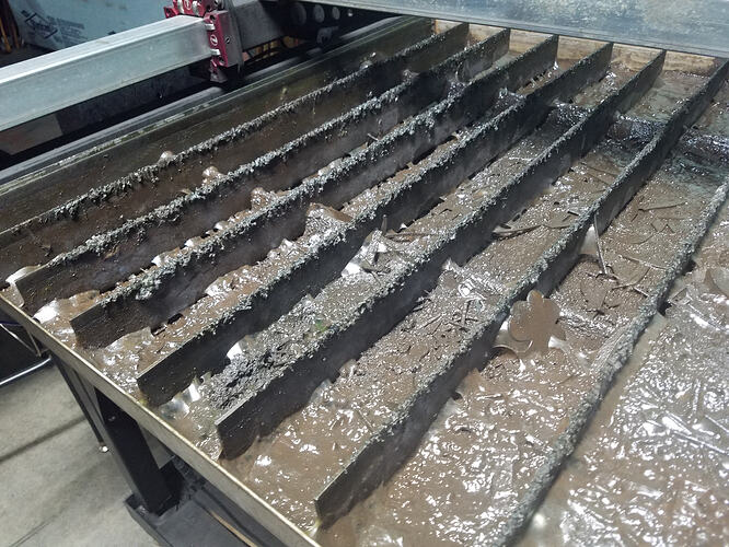

While were on the subject of water table growth inhibitors, I DO NOT recommend Pico Quench. I bought and used 5 gallons when I first purchased my L/S table. I got a slimy growth that kept coming back even after draining, drying, and cleaning my table.
Initially I thought it was due to the one time where I added a gallon or so of water from my garage roof rain barrel, but after several drain/dry/water (municipal water) replacements I still got the same slimy algal growth cutting only mild steel.
